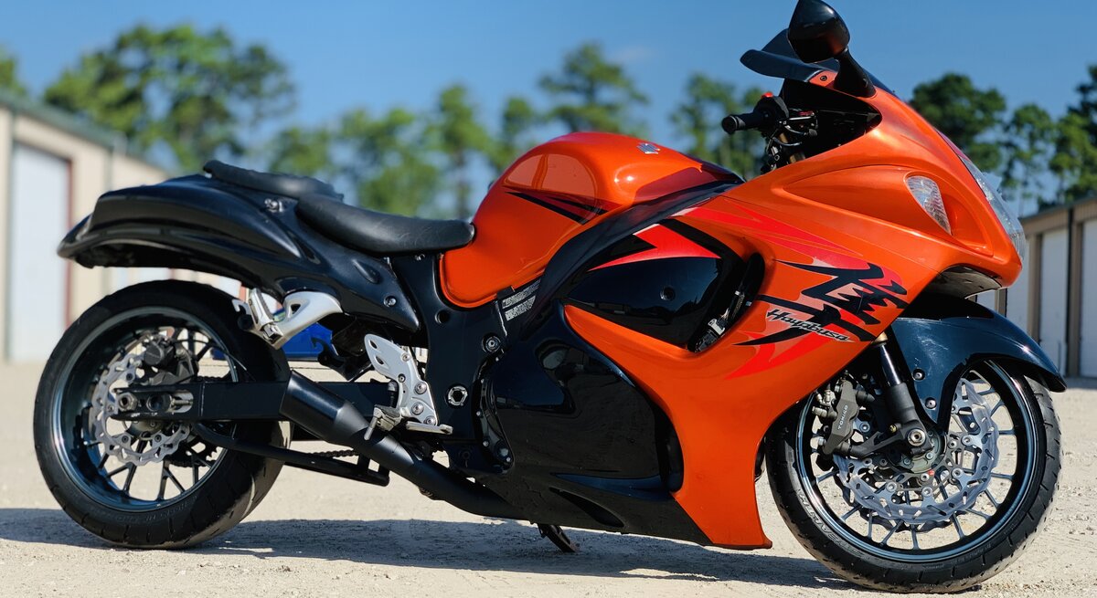

Did you click on the thread I posted below the pic of my bike???
Pretty much lays out every mod and accessory I did to the bike

Ive built NA 1441s that put down 220+ real rwhp, not advertised. Ill not speak to the mods and stages the big names have versus what they would put out on another dyno. Ive had and still do setups that make more than that. However, the most fun combination and affordable combo ive made is a std bore gen 1 at 13.5:1 with 2 intakes and a mildly ported head at 104/106. 190ish to the rear with an unbaffled sidewinder. The power is right there and its not too much to just spin. My 1441s are great, however, I wouldn't want to go a long way ride with one and they do not like stoplights or 25mph or 30 for that matter. Neither does my zx14 which is essentially a mild stroker. Just my 2 cents. A lot of the guys at the track have dailys that are gen 2s with a 40 shot. they run VERY good. id say that's the easiest way especially since you don't need a piggyback nitrous controller and all in all less than $1k including tune.
