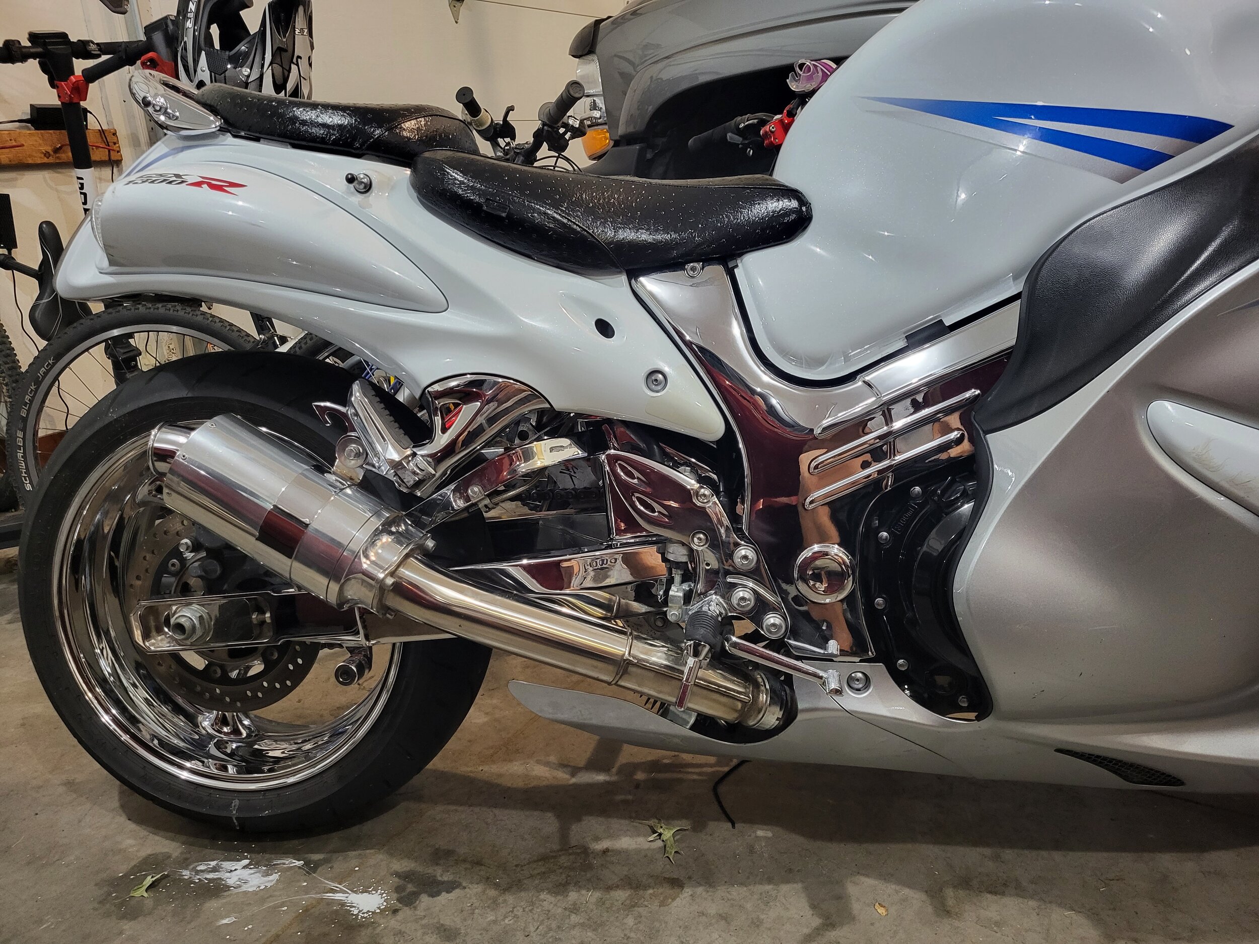

So sorry. Just getting back from work.. trucker life.. lol but I measured like a little less than 2 inches.. I heard voodoo pipe ends are a little wider than stock pipes.. but here are some pics
I have a voodoo header on my gen 2. Bought it with it. It was too loud. I am using the stock mid pipe on it now with a bolt on d&d can. I would bet you can get a stock mid pipe on yours as well. If the stock mid pipe fits a slip on should also fit.
