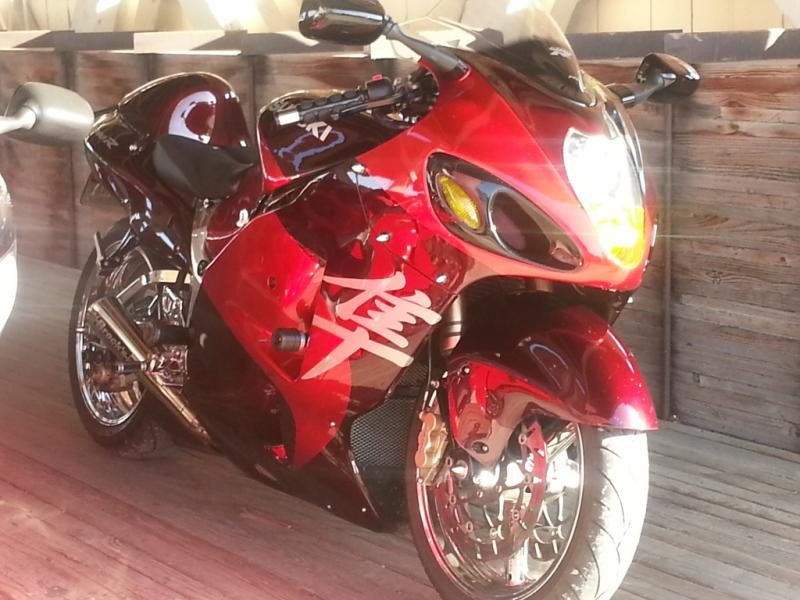

Busa Makeover.
Looks good brother. Load test that battery, you might have a bad or weak cell.
