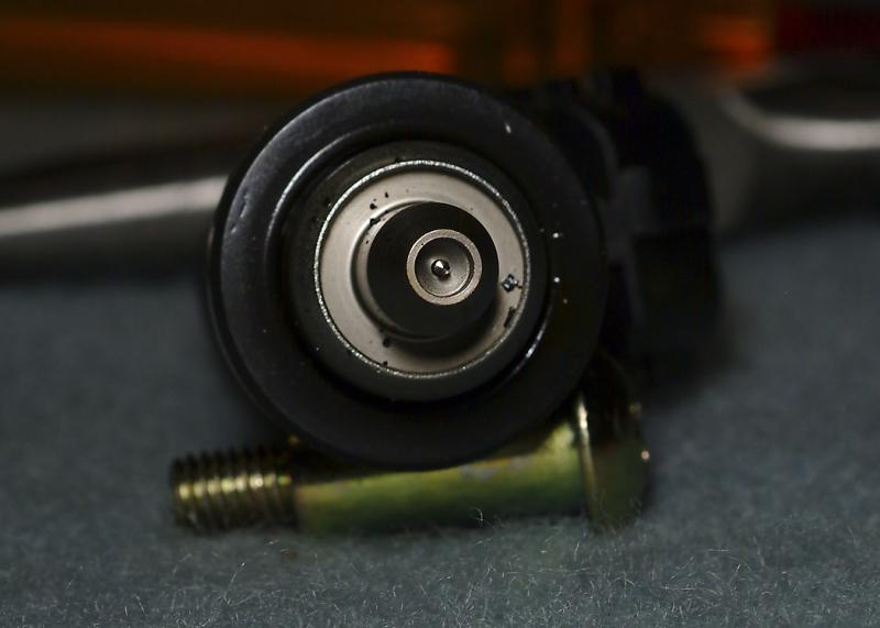

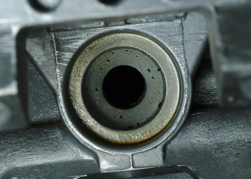

Fast forward to today. I'm attaching images of 2 of the injectors and 2 of the injector holes. As you can see there is some debris. I will clean them up the best I can.
Carb cleaner on the injectors and q-tips around the holes trying not to let anything fall inside.
Any tips are welcome.
I don't know if Stabil could have caused any of this debris but I don't ever plan on using it in any of my bikes again.

Dude, that debris is on the tip of the injector, wich is inserted in the intake manifold, right? What am I missin.
If so, those particles are from inside your intale manifold/cylinder area.
Are they metalic in nature? Check hardness, crush with a hammer gently to see what they are made of. They could be carbon deposits from the valve seat that got blown back into the manifold...
Just for the helluvit, pull a comp check.
My bet is on plugs. How old are they. Never hurts to change them out to eliminate them since they do fail and still look "new".
Thanks for the ideas. I didn't/don't see any of the debris on the "tips" of the injectors. The tip's look good. The debris looks similar to the stuff that I found in the gas tank, only smaller.
The plugs are OEM. However It only has 4500 miles. However the point is taken that they could be bad even if they look good ???
If anyone has cleaned their injectors and had good results I would like to hear about it.
If I reinstall everything, and it doesn't run any better then I may be forced to take it to a dealer. If I reinstall and then take out the injectors again and find any debris, then I would know it's coming from inside the intake manifold and not from the gas since I cleaned the tank and put in fresh gas.
One more point is that even though I blew out the fuel filter, that too is an item that could look OK and still be bad, right. When I called Suzuki they said that the filter was not cleanable. For $329 it should last a lifetime!
