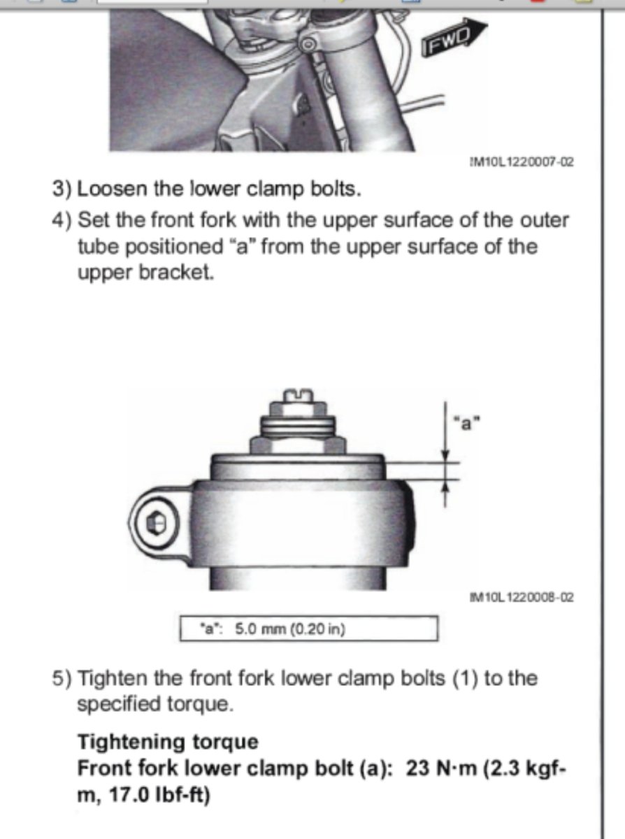

So the issue is, i have to raise the triple clamp (drop the forks) to use the factory bar mount as the factory one doesn't slide down over the fork tubes like the lowering kit mount does. The top of the triple clamp has to be 5mm below the top of the fork tube to use the factory mount.
Maybe ALIF makes a riser but I didn't find one

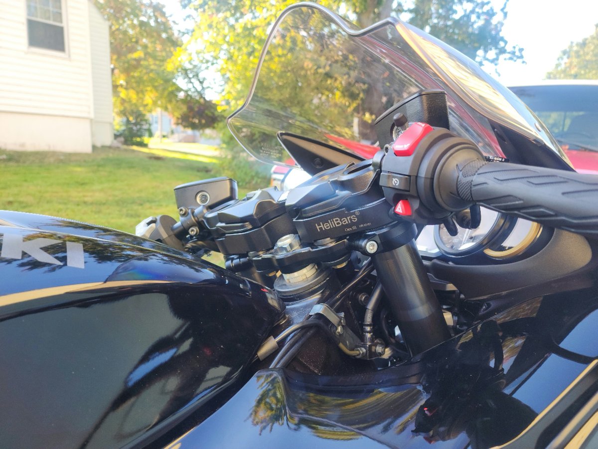

Well I got things sorted out the way I want them today.
I purchased a Helibar riser which comes with longer bolts, also bought the handlebar cushions, and bottle of blue loctite and today removed the ALIF lowering bar mount and bars. The Helibar took up the space at the top of the fork tubes and the factory mount went on top. This setup also re-used the bushings and rubber mounts so I didn't have to buy those. The end result is my bars are a little higher than stock bars but the bike ride height is still lowered front and back. Not wanting to return the bike to stock ride height, this is the ideal solution for me.

Pain in the ass getting to those 4 bolts
LuapSouthFlorida
Nov 15, 2022
183
385
You can say that again.
I mean don't say it again really :laugh: but yeah
Removing the windshield gave me room to work on the front two but even then you could only turn them a few degrees at a time.
