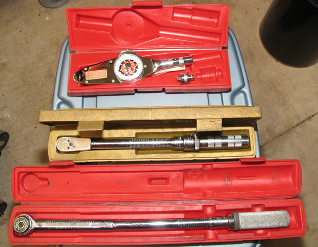

I could not decide either
top to bottom
1/4" 1-75 in-lbs
3/8" 15-100 ft-lbs
1/2" 30-250 ft-lbs
I have had them all tested a few times for calibration. the 3/8 is 10 years old, the others are almost 30!
Buy a quality one and it will last a lifetime!
