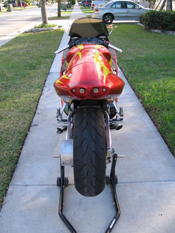

Sorry I don't have a good picture. Maybe you can see the location off it, if not I'll try to post an up close one later. I made 2 small L shaped brackets out of stainless and put a 45 degree bend in the middle, and drilled a hole on each end. I used the rear mudflap bolts to fasten it.
I also got a tag light off of a Ford Ranger for $2 at the junkyard, cut a small hole in the rear of the black plastic undertail(with the tail off) snapped it in place, and used male/female snapconnectors to attach the small harness to the factory tag light harness.
Cheap, simple, and tucks the tag up cloce to the tail at nice angle.

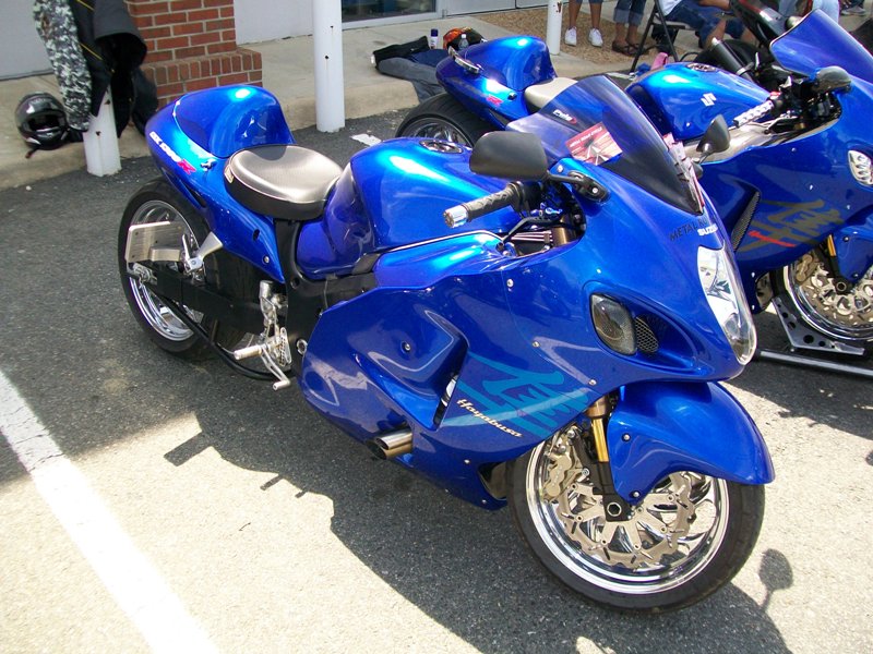

Homemade, ie free
I made mine also by taking a piece of sheet metal, cutting and shaping it to fit center mass to the undertail.

Where's the 20 dollar LED light bar? Lol. And actually, can I get a couple more detailed pics of that first homemade bracket? Does it ever loosen up since it's just with one bolt on the passenger pegs? Thanks.
