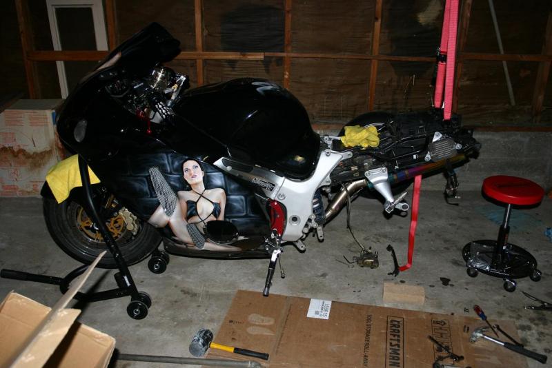

-ps:i just yanked my 9" arm off becuse somebody bought it, so just went thru removing the arm again-castle nut came off just fine w/the punch again.
