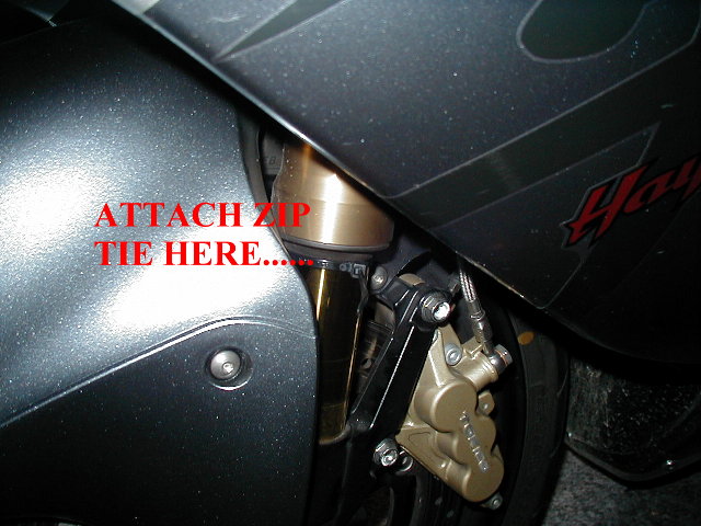

That's "The Magic Number" folks...PROPER LADEN SAG SHOULD BE 3.449 That's the measurement you want between the top of the cast fork end the the bottom of the fork seal dust cover..and measured as follows...with the bike resting static on a rear stand place a zip tie here like so...
badboysbailagnt
Jun 24, 2005
775

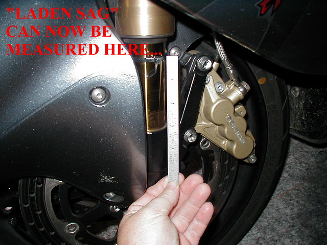

Then gently mount the bike (while it's on it's rear stand) slowly lifting your feet to the pegs and assuming your riding position...then gently dismount the bike and then measure like so and HERE is where your looking to hit that magical 3.449 "Laden Sag" dimension...
badboysbailagnt
Jun 24, 2005
775
As you can see it's apparent that I missed my magic number by about .300 and had about 7mm to much laden compression which indicates to me that the springs are too weak..as I suspected they would be due to the fact that the static weight of the bike itself had already gobbled up the lions share of compression before my @$$ ever hit the seat (and that's the impotance of taking "Static Sag" measurements)...and IMHO the Busa flat out needs stiffer springs up front...and that goes for anybody...sans any sub 150lb flyweights who might get away with using the stock oem fork springs..but I wouldn't recomend it..the Busa has proven to me it needs stiffer fork springs....and now the good news...
