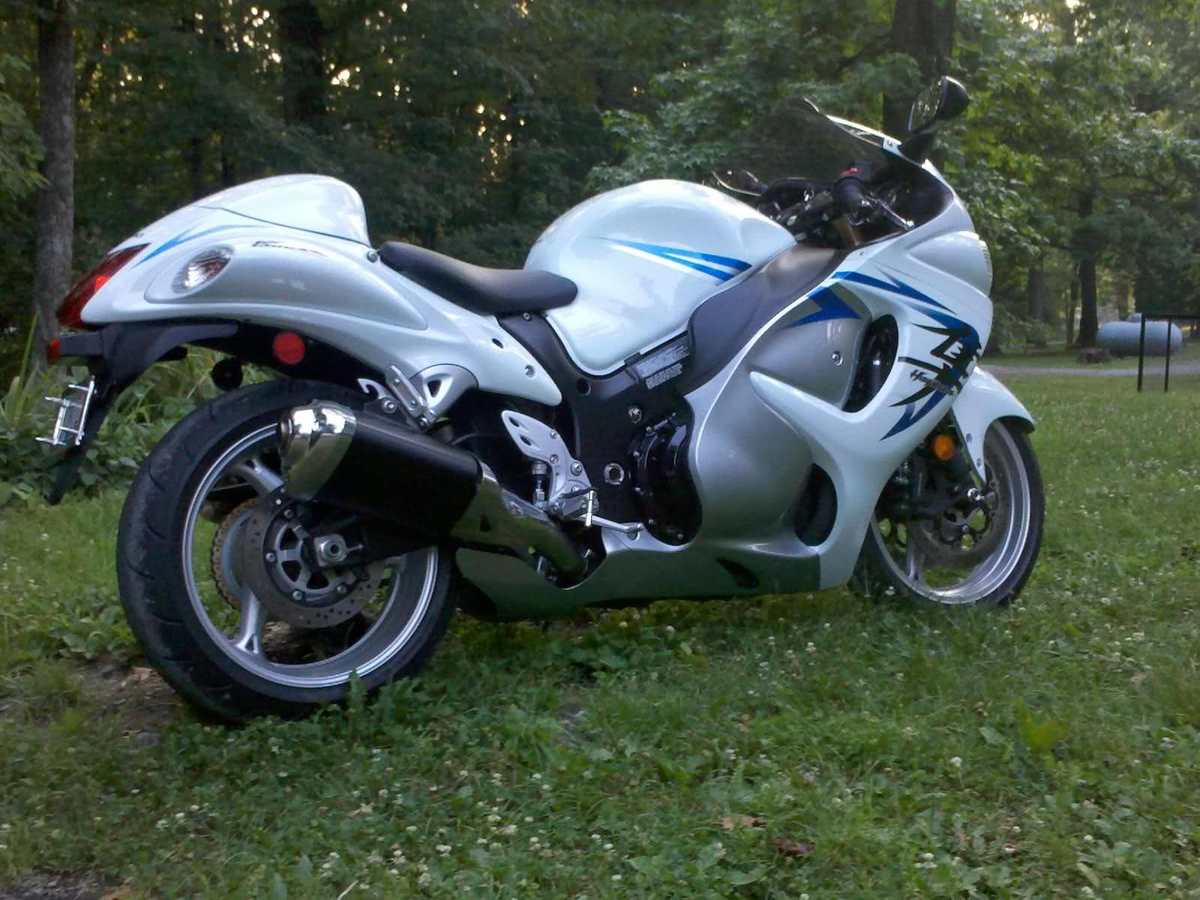

Thanks for the compliments. :beerchug:
With the end caps I havent finished yet. I actually got the wrong thread pitch in some stainless button head bolts. I had to bend the 3 flanges in so the chrome end cap would hide the pop rivets.
It was so hot and humid here yesterday here in TN that I was dehydrated near the end of the job. So rather then rushing and taking a chance I figured I would finish up today. Right now I have 2 screws holding the end cap on, one factory shorty and one allend cap screw that was longer.
No drilling, but its defenitly a deeper tone with no raspy sound.
I dont know know what the inner pipes are made of but mudda fukr they are hard to get through LOL!!:rofl:

LOL! As matter of fact the reflectors came off today! :thumbsup: Finshed the end caps with stainless steel button heads and chrome flat washers. I did have to drill the holes out a lil bigger since the flanges were tapped in so the end cap covers the rivets. Came out good looks factory.
Yes, that mudflap on the back looks like something off a dump truck I agree.
I am just not sure how its going to look with the standard length swingarm. I am looking at options now, no I dont want to extend the swingarm, I kind of like the roll on torque wheelies in 1st, 2nd.

Yeah I used the high temp copper silicone to seal the end cap and then used 6 huge ass rivets to hold the end cap on. I read where some have drilled 1/2 in holes through the inner to get a louder sound. I didnt really care for that raspy loud sound. The shorter mufflers with no holes sounds like a turbo bike sound, deep and quiet with no rasp, just deep. I didnt lose any low mid or high end. Still pulls the same, by the seat, no dyno or ET to compare any difference.

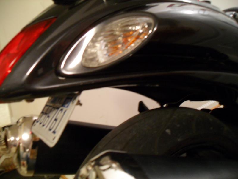

I had stock shorties too, they're now different slipons. Here's a shot of them with just the tag and no mudflap. My Dad made me some ss brackets, but Blanca Busa has a DIY thread where he used his rear reflector brackets as tag mounts. It does a great job and alot of members have used it.:beerchug:
Looks good.:thumbsup: What kind of seat is that? Do you have any pictures from the back? Also do you have a link for the thread on the mudflap removal?
Thanks
It's a Corbin seat. These aren't very good pictures either, but all I have. I'll see if I can find a link for Blanca's tag bracket thread too. If not I'll pm him to post it here for you.
