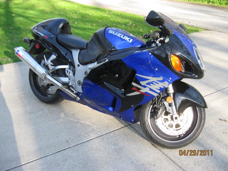

Its just slip ons. Think I'll try a set of plugs. It doesn't seem to have any problem in the power department. The other day I did a little WOT in first and second and it lifted the front end and wanted to carry it even with my 240 on it.
