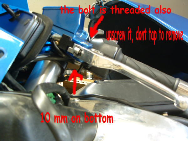

tell ya what, I'll do a re/re for ya, with pics....be right back

ok, pullin' that puppy....
10 mm wrench.... common or (flat blade) screwdriver
excuse the mess...its bin a fug of a week
the pin for the clutch master will stay in place, so will the starter motor clutch switch...
they will stay in place for you nicely, thx to the rubber boot(on the clutch master actuation pin), an' the fact that the switch is bolted to the lever perch (or housing,if you prefer)
you may need to press out this brass bushing, the new lever probably wont come with it, or the adjusting mechanism.
you'll need to re-assemble the lever.
don't even attempt to do this operation, without the proper attire.
you must have a fully sanctioned, factory endorsed, officially licenced ...
LOL, can't get any easier than that unless i drove it to you to fix for me.
thanks for the pics. I was worried about removing a cable, etc,
very straightforward
