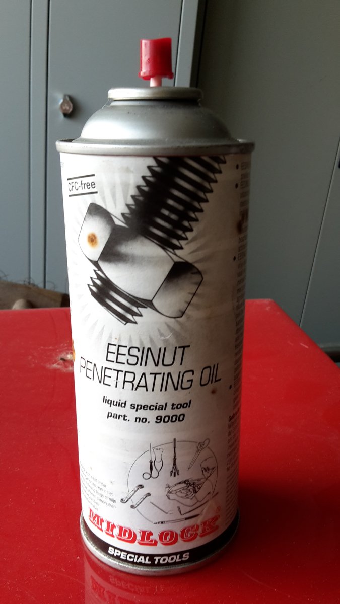

I never ever use WD40 , ONLY Midlock Eesinut WORKS 100%
Parts been sit and rusty 14 years ,came loose with this FAB Product
