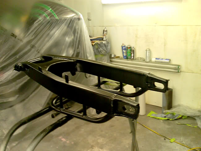

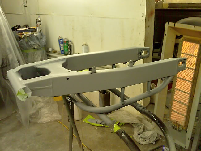

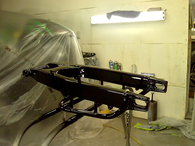

I ended up tearing the bike down to bare frame and prepped both the swingarm and frame for paint.

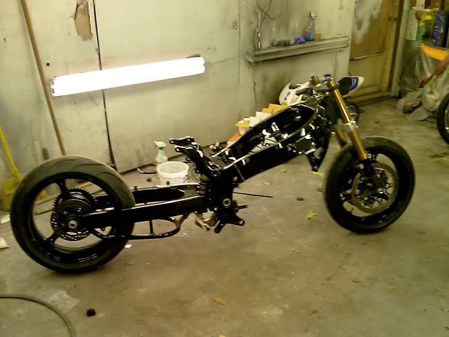

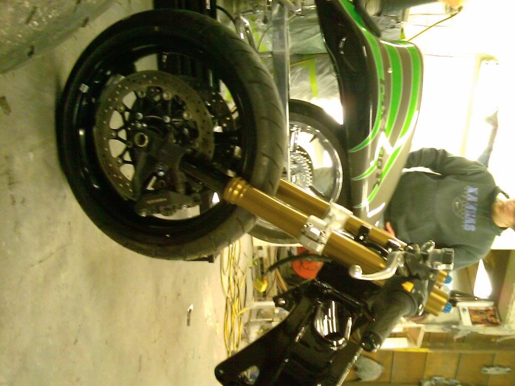

Then I decided I'd go with a GSX-R 1000 Front End. I'm kind of kicking myself in the head for doing this as I'm having minor issues with it. I used a full front end for a 1000 and it fits fine. Only problem is ignition can't be bolted onto the triple tree because it hits the upper mount for the fairing stay.

If you use the busa clamps and wheel everthing should bolt up, except for the fender!

never tried this but since you already have the parts....try the gixxer lower tree and the busa upper and see how it works.
Will the brakes line up as well? I thought I read somewhere that spacers were going to have to be made for everything to line up. i was trying to avoid making spacers that's why I went with the 1000 wheel.
Can't, the GSX-R lower tree is narrower.
then you will have a 1mm gap on thge lower fork tube...clamp does tighten up but the concept scares some people. You can always use a metal shim/spacer. Top clamp/tubes are very close in dimensions.
what are you doing about the rotor situation?
Everything fits fine as it sits. I just have one problem with fitting the ignition.
