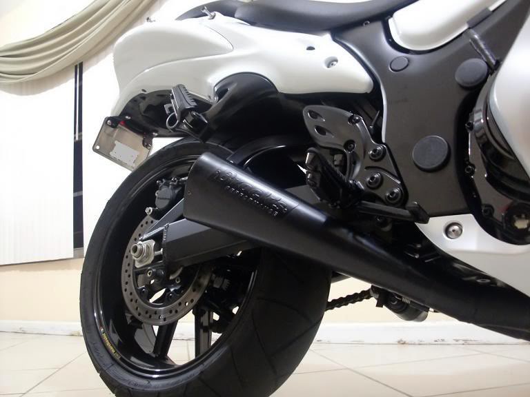

SKECHE
Aug 16, 2010
2,552
25
heres a quiick look at mine....love the look...i kept the hanger holes and put the busa plugs in...i also kept the hooks, just incase i use my cargo net.:thumbsup:
