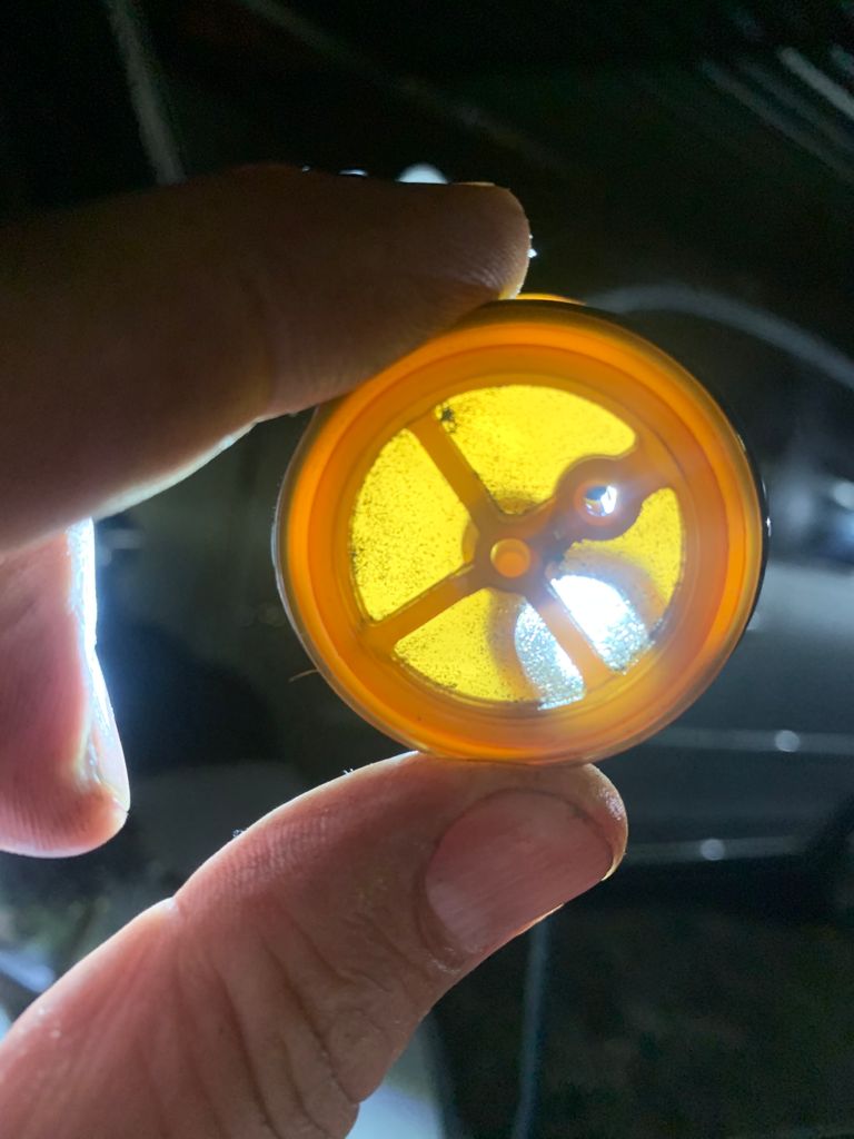

my thought is still that there are issues with the fuel flow
(additionally combined with an eventually dirty air filter)
remember the bike is 21 now and if the pump filter(s) never been cleaned this often is the reason for issues.
they appear to be quite susceptible to it - i had that several times in the last few years.
by the way - what then should be cleaned at the same time are the injection nozzles - they also tend to get clogged (a bit).

Stripped the tank and pump took the pump apart and found that the pump doesn't have to top paper filter, checked the mesh filter for the fuel pressure regulator it was spotless. took out the bottom filter and it was clogged, I cleaned it and got it spotless.

Installed a filter and replaced the current fuel lines as they are not 100% anymore.

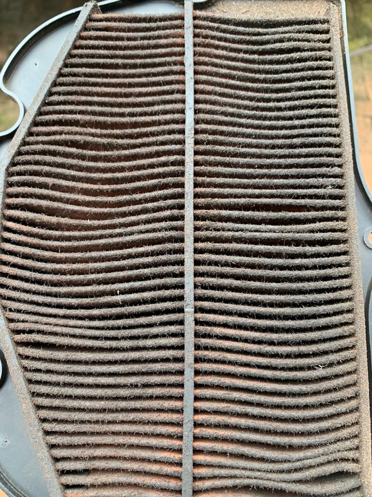

Next was the airbox, surprise surprise, they never replaced it when they rebuild the motor 3 months ago. Mechanic to investigate that and give me feedback. I cleaned the air filter as good as I could as a temp solution

I haven't taken it for a proper test ride as the roads are wet and we only finished later with the bike. I hope these were the cause of all my problems.

FYI, I only use the stock OEM filter and never clean them. I replace with new every oil change. You will find a new unmolested filter makes a noticeable difference in performance, as the Hayabusa is thirsty for air flow.

I agree with you on that one, but it was supposed to be replaced when they rebuild the motor and never did that so I am waiting for the shop to sort out their "mistake". and supply me with a new filter.
