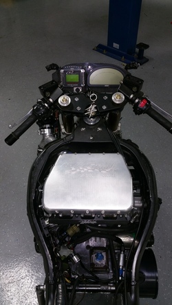

Shifty thats a frickin sweet set up.:thumbsup:
Obvious question is obvious: what battery/stator are you using to power all those electronics?
I have a Rick's rewound stator and a ballistic 16 cell battery. But that doesn't matter. The tablet runs off its own battery, no impact on my bike's electrical capacity. I have a usb dongle that plugs into my battery tender lead that I COULD use to recharge/power the phone or tablet but I have never had to. I get home from riding, pop off the tablet from the mount, take it inside and charge it. Done and done. I am betting my Aimsports Dash and AMS-100, being LCD based probably draw less power than a stock gauge set.

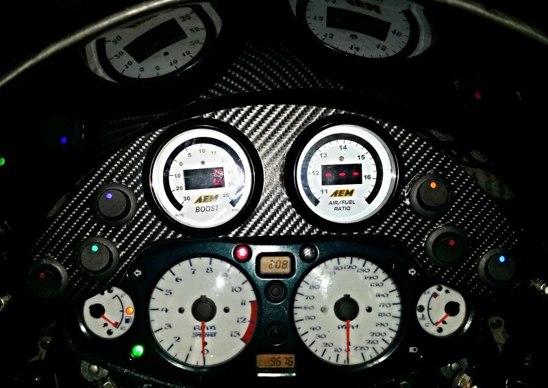

AEM Air/Fuel and Boost w/ switches (2nd fan, intercooler pump, AMS, AMS activation, camera/monitor, map switch)
fuel pressure - analog, mounted to FPR. oil pressure - only logged by AMS2000 (analog gauge used during initial start-up/tuning)

nice I like the gauge above the stock gauges. don't see that very often. where is the map selector switch for the 2000? shud hav mounted up there somewhere. looks sweet tho.

Thanks...I've never been fond of the triple tree mount and dash areas. I haven't mounted the "2000" switch yet as I'm not entirely finished with this build. I was thinking about mounting it under the dash trim with only the selector knob above the plastics (with 1-5 positions labeled in the paint since I'm going to strip and repaint the entire bike again)
