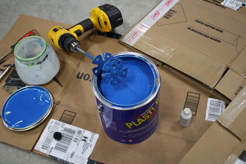

what brands of plastidip do you use? Do you think they would be good to use on a cabinet. I wonder how smooth it would be on wood
All the stuff I buy comes from dipyourcar.com. I believe it's just called Plasti-Dip according to the side, looks like it's made by Performix
I should have posted these pictures in the OP.

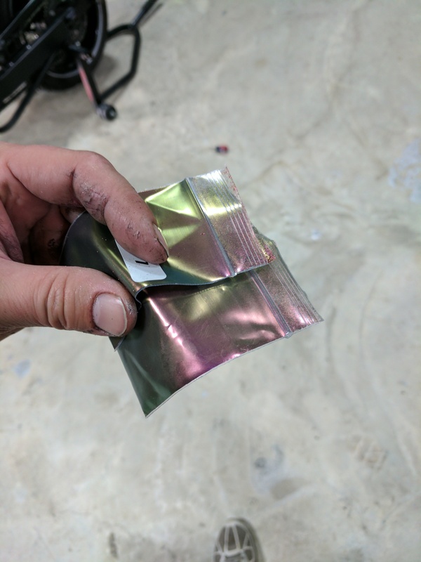

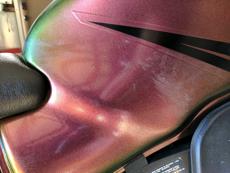

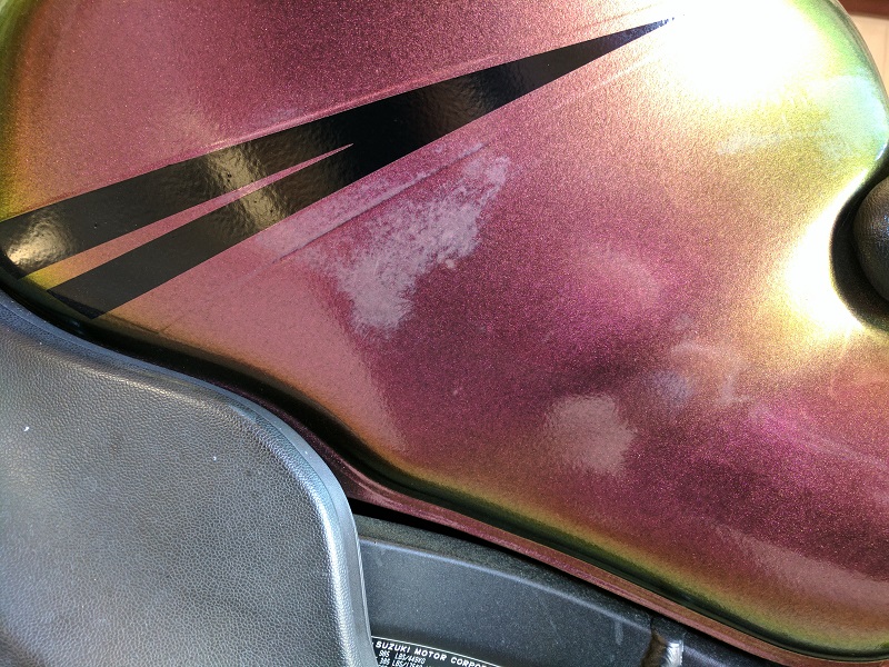

Thanks for bringing this back up, I've been meaning to update the thread and something I've learned with using the clear TopCoat. This is the 2nd time I've used TopCoat with the prior having pearl mixed it in, but didn't have this issue. This time I had the pearl mixed in it, then went back over with 3 more coats of just pure TopCoat. Where my riding pants rub against the tank, this happens. It's not really a big deal as I can spray a little DipCoat (I think it's basically a spray wax) over it and it goes away. It took about 10 daily rides for me to notice it, so all I really have to do is use it more often, which I should do anyways.... Keeps the dip feeling like real waxed paint too.

Wow i thought is was more durable than that. Just riding scuffed it like that?
InfiniteReality
Oct 24, 2005
2,251
2,667
Just riding scuffed it up between my riding pants and my jacket. The first 2 times when I didn't use TopCoat, I didn't have this issue. Even when I used TopCoat with pearl (blue) didn't have the issue. With clear TopCoat by itself, I this happens. Honestly it's not a real issue, just need to wipe my tank down when I put it up for the day and I'll never see the issue again. But I wanted to post pictures to make other people aware of it if they wanted to dip.
This may be hard to describe, but when you dip with just Plasti-Dip the stuff feels like it has a rubbery feeling on it. I can put DipCoat(spray wax) on top of it and it feels alot more like real paint
When you have TopCoat on it (like now), the stuff actually feels tacky all the time until you spray DipCoat(spray wax) on it, then it feels exactly like regular paint with wax on it. The think the reason it shows up on my tank now is because once the DipCoat is worn off, it goes back to being tacky feeling and that happens.
