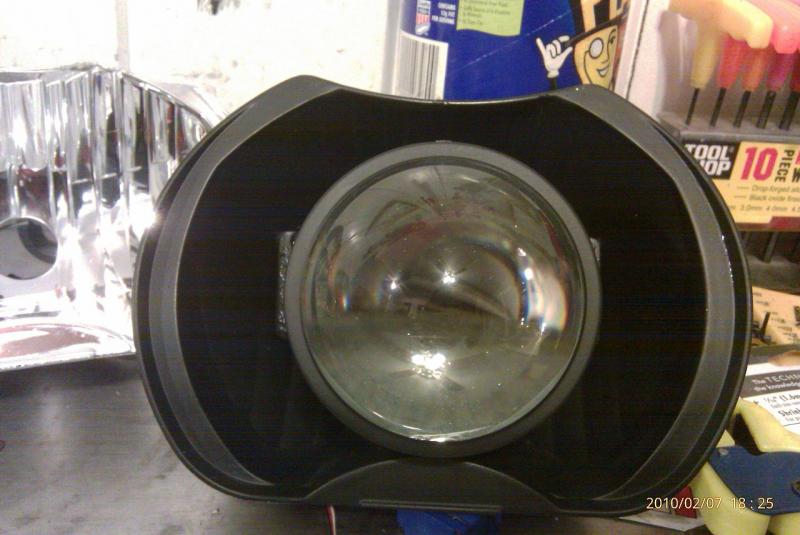

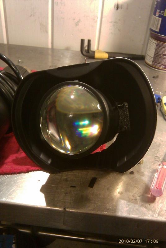

What I have done was retrofitted a stock hayabusa projector assy
into the reflective bowl. I blacked everything out. And I used a trick of
bending the inner cut-off shield in the projector to extract more colour.
so i can attract more attention to myself with dazzle.
I utilize a stock reflector bowl so that i can still use the aiming
controls. Hids in both projectors aswell.

thanks guys! tonite i will give the shot of the original projector i have
only modification to that one is to position the flood area, as it was opposite
in stock form. my bending the shield slightly, I sacraficed a straighter cutoff
for more colour at the cutoff, and really different colour output overall.
worth the trade. not to mention without aiming, both projectors were almost
spot on same position, i just have to slightly lower them both

i've fathomed the idea of retrofitting a projector in for many years
but now that i had to open up the headlight, i took the time lol
i wanted to use an Acura TSX projector or S2000
but i found the stock was adequate enough though.
Ive done the same with other housings for cars.
but it was trial and error. i was content not to fail
with this one lol. But i love the blacked out look in it

oh yes sir, i love it night riding or day riding.
im seen more easier.
i made a post before how i modified the highbeam projector
internally, and used it as low beam. the flood of light is superb.
tons better than stock. also ditching the reflector bowl setup
its TONS better light output, hid or not. light is projecter where it should
and not scattered every direction

If you don't mind; How do you get the headlight apart like that? It appears to be all plastic welded together or something. :dunno:
KhandyRhedBhusa
Jun 3, 2008
151
its epoxy resin,
using an oven to place the light assy in, low heat say 200 or so
works best, quicker, but more dangerous as you would have to be
carefull not to damage the soft clear plastic by oven rack print,
or even fingerprint lol.
this time i used a heat gun, spot heated where the casings meet
and presto. pry until they come apart. safer, but slower this method
