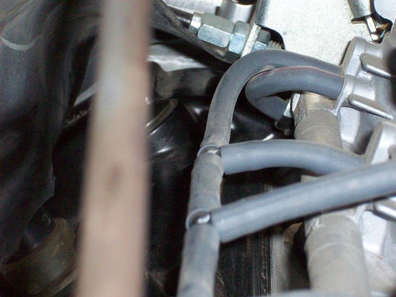

Did the marble mod, worked perfect, then ordered the block off plates for my 06. I understand how to cap off the the big hose that goes to the bottom of the air box. There is a little hose that runs from the top of the pair valve to the front right throttle body. Do I just cap that off? ???
Many thanks!
There is 1 small hose that you cap on the far right hand side.
