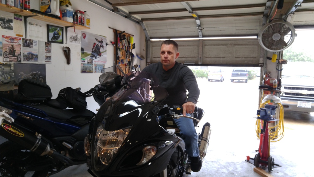

Seat 100% better than oem , driving lights , and ABM bar kit came in today . Ill get it installed this weekend after turkey day . Also have heated grips as well now .
Cake topper got to leave company car @ home , and ride into work today :)

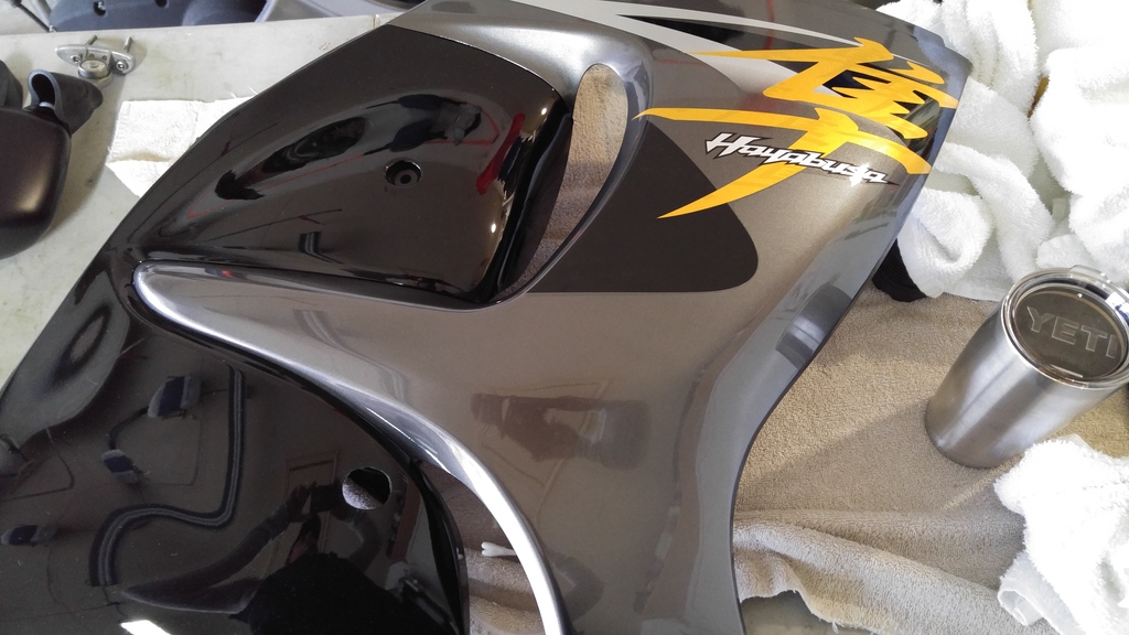

Captain here are some pictures . FYI fairing drilling required . Left side ( stator cover side ) half moon the fairing with a round rasp / file . Course works better than a fine on the plastic .
Also Ill need to find link for lights from ebay motors for you .
Hardware M8 x 1.25 couplers with some 10 mm M8 allen bolts if I remember right . Red lock tight them into the coupler . then a few spacers to move lights away from body panels .
