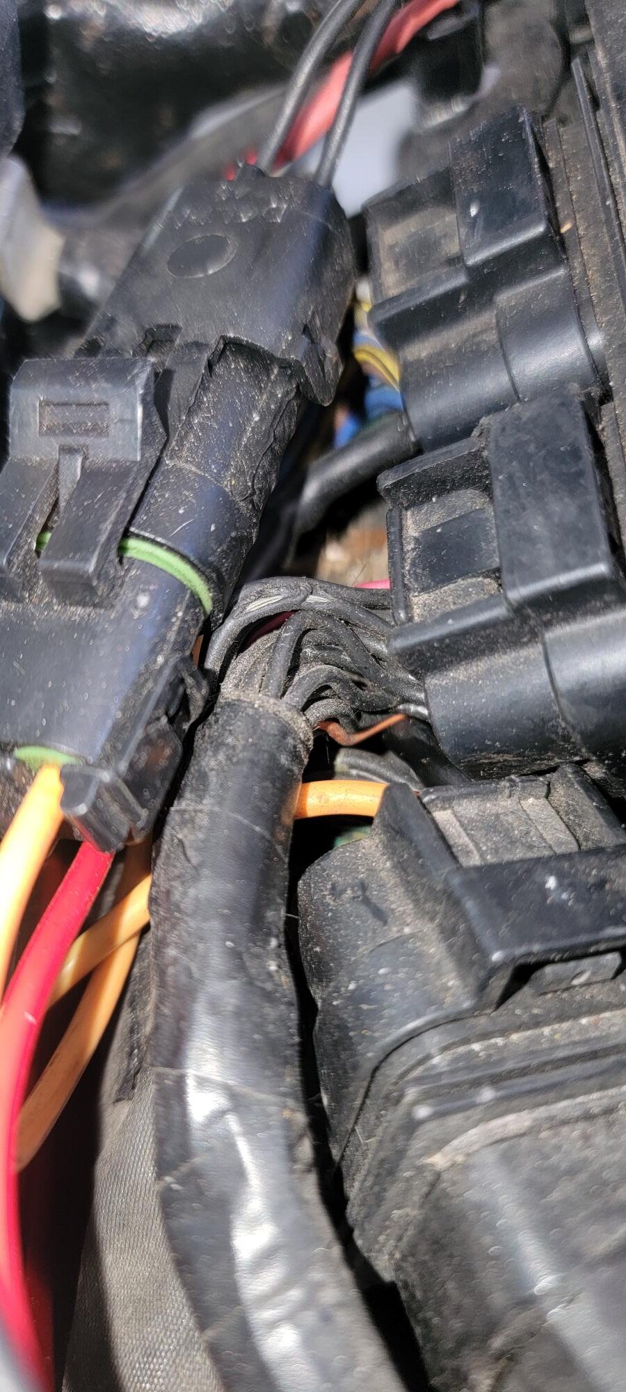

I'm trying to put my 01 back on the road and mice have gotten in to eat some insulation at the ECM connector and I want to take the effected wire out and put shrink tube over the effected area does anyone know where i can get the proper tool to get the wire out.
it's the 26 pin connector
Thanks

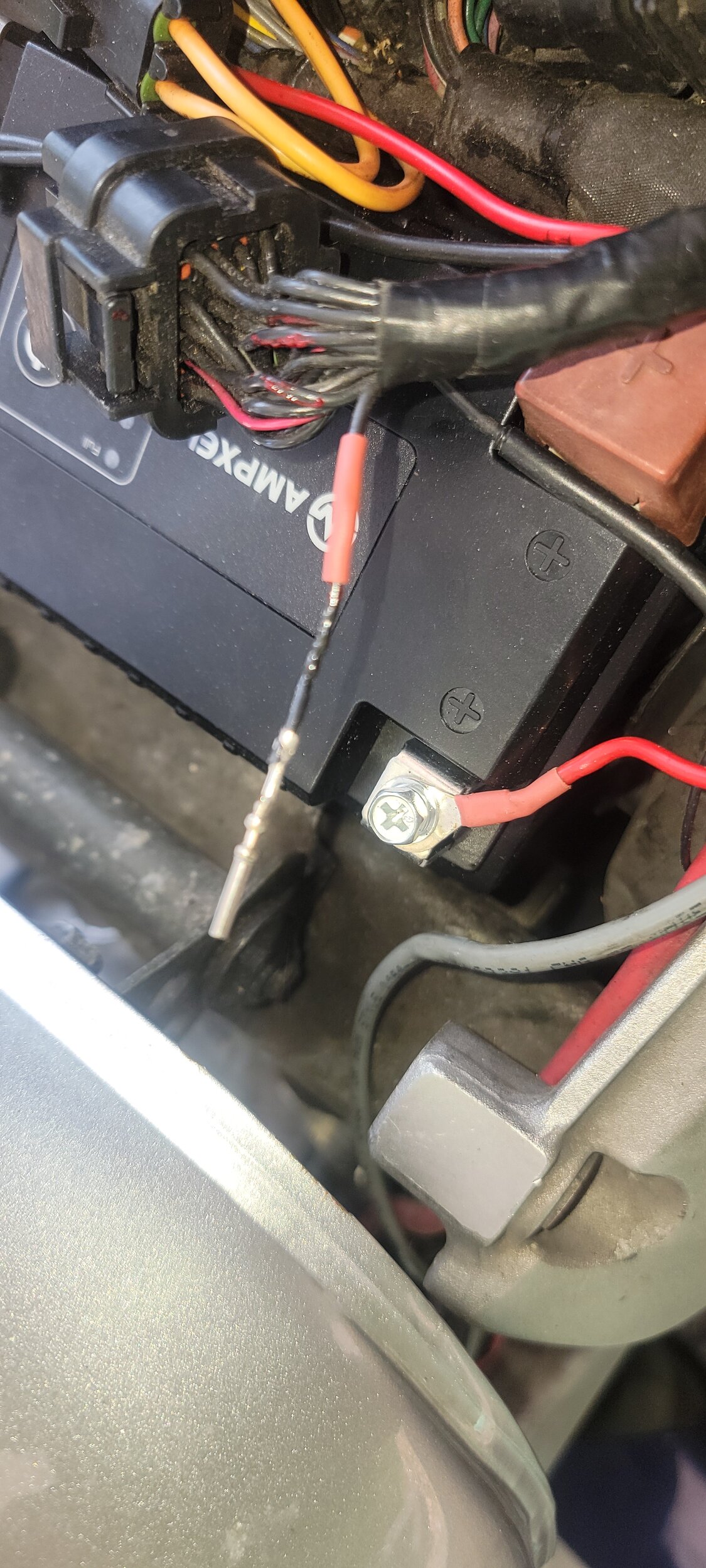

thanks Smithbusa, although I'm not sure what you mean by the white tab as I can't figure out how to take apart the casing of the connector.
I will look at it as I'm going to the shope now try and work on it agian.

Well that looks easy.
Thanks I'll try that tomorrow:thumbsup:

I have done it probably 18,000 times
Tip make sure to look close and visually inspect that you haven't pulled any out
If any are out a bit pushing the clip Back will be hard or impossible
DONT FORCE IT
