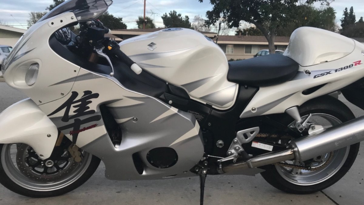

I love that Gen 1 bodywork. Nice white busa you got yourself.
