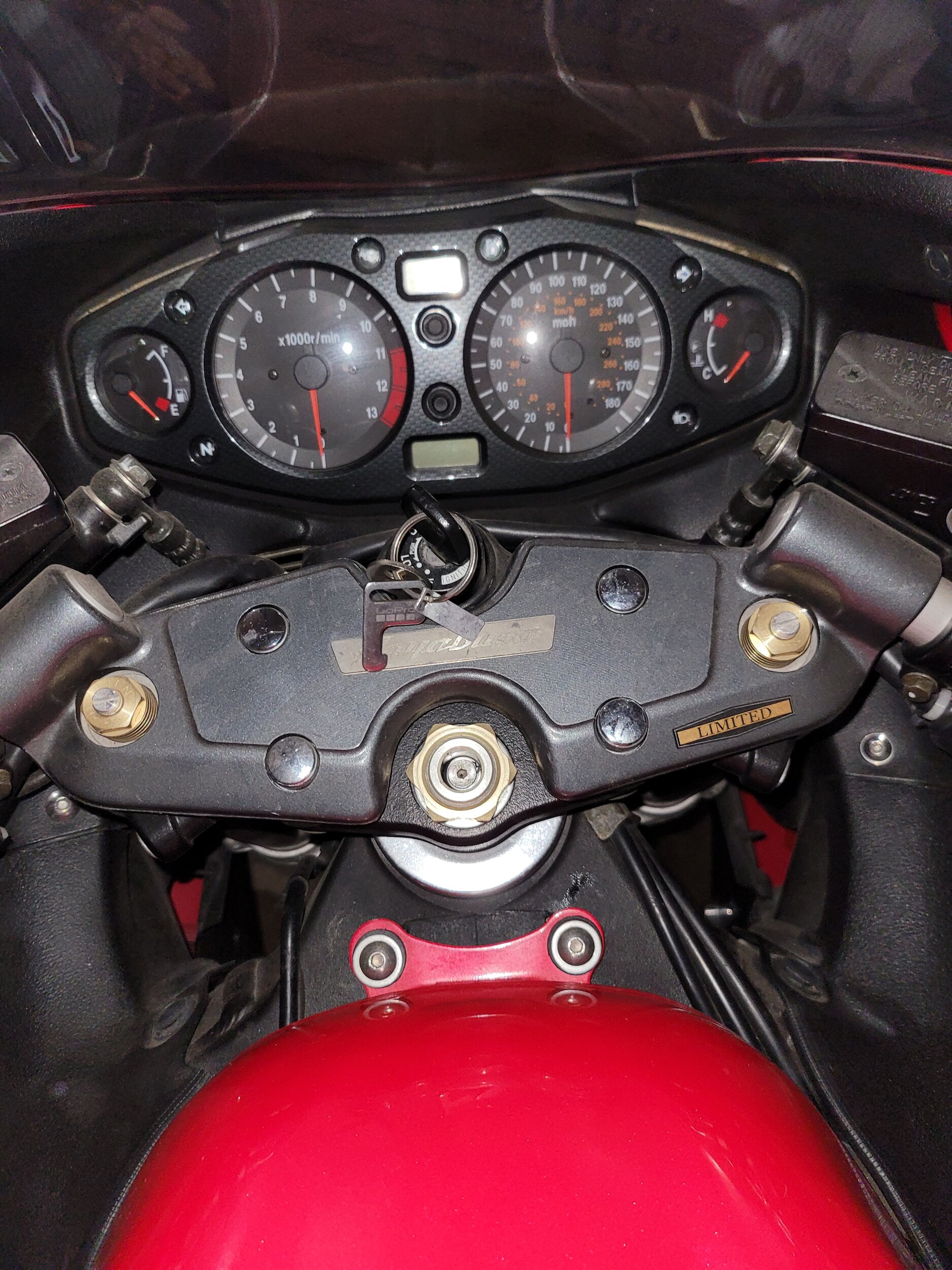

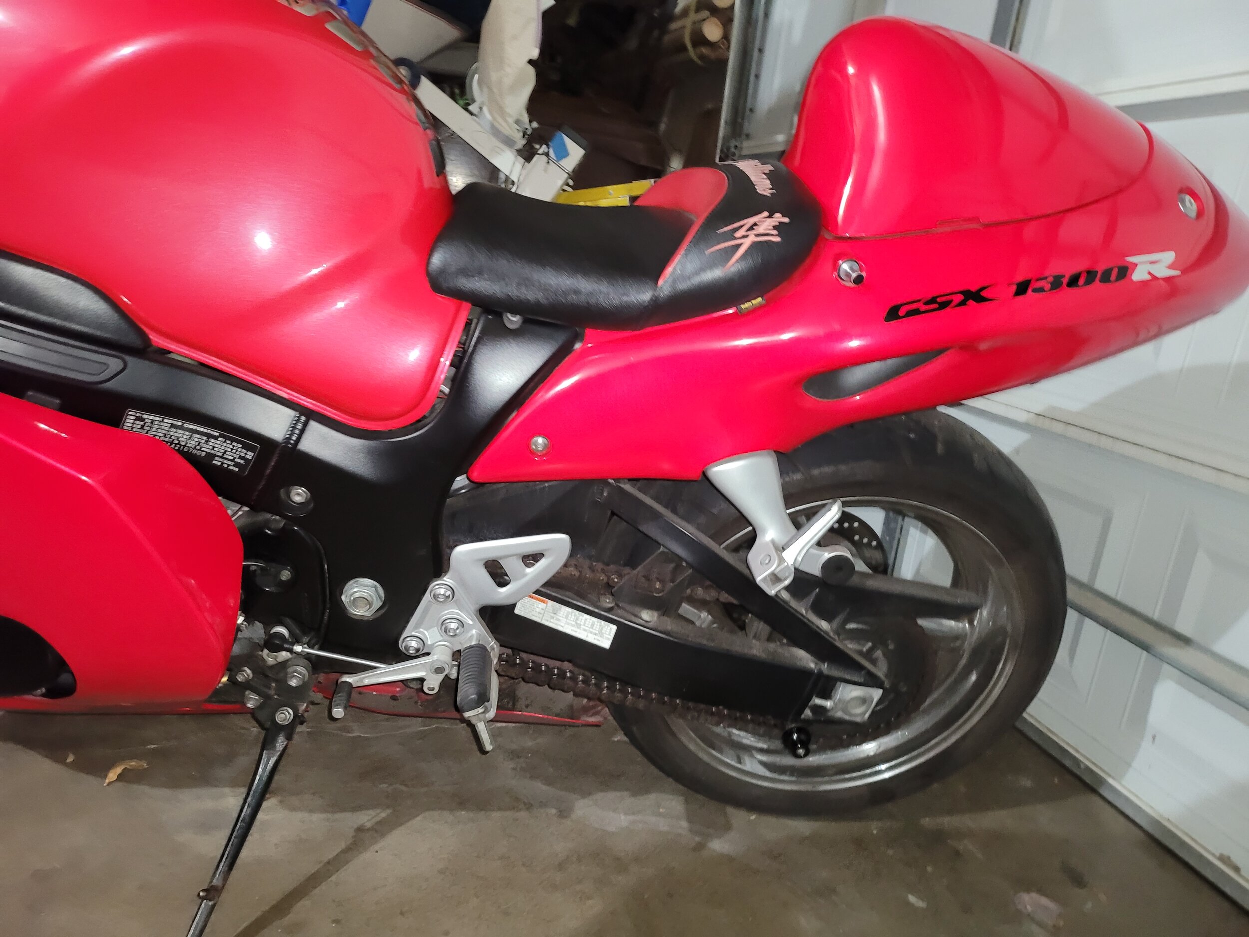

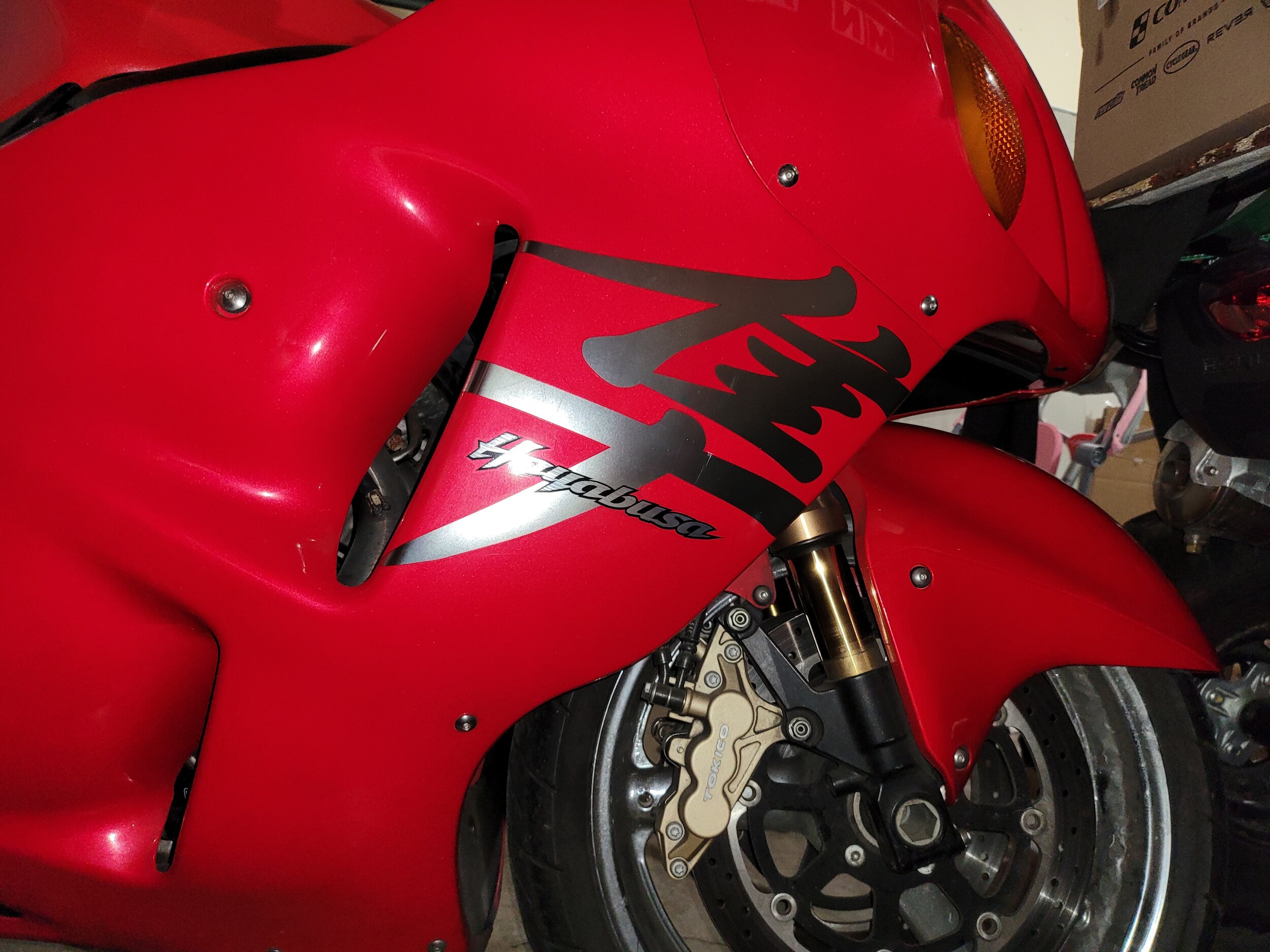

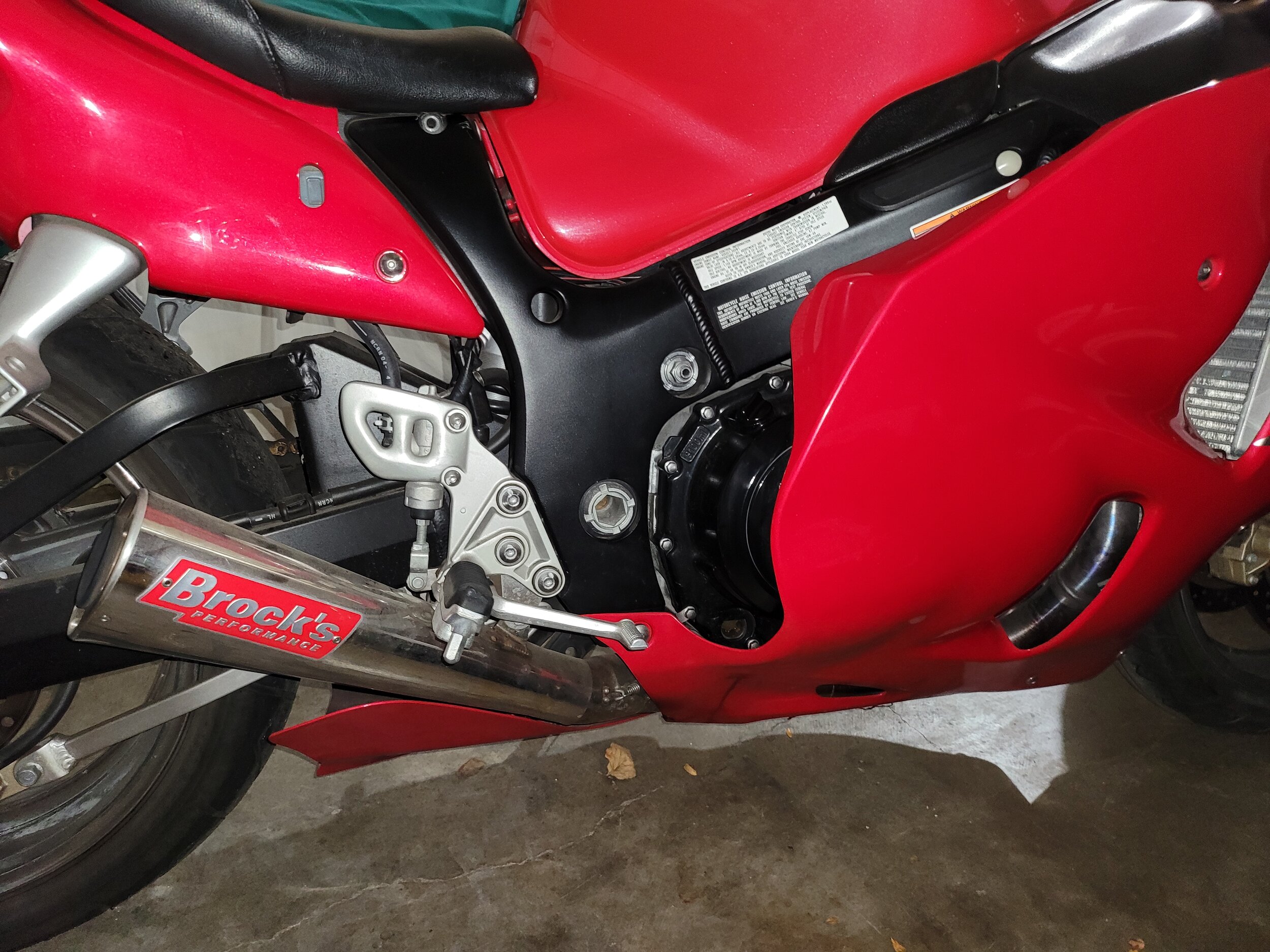

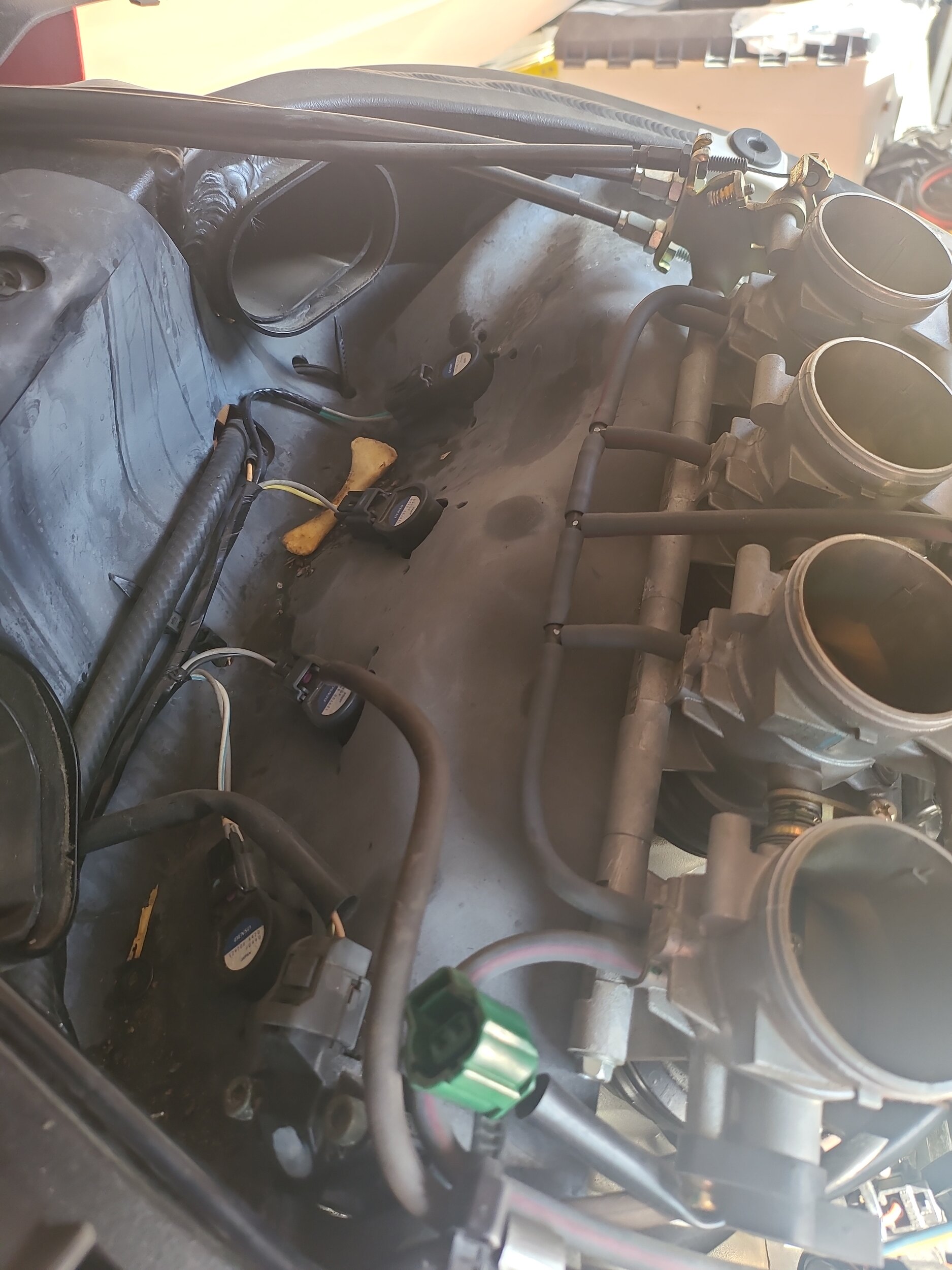

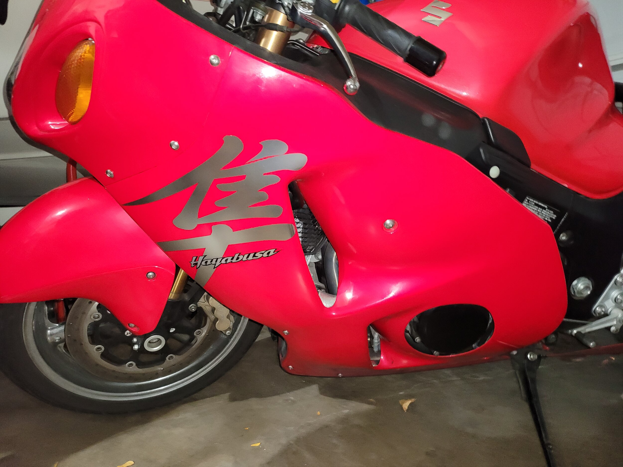

It's cold and almost winter so these are the best pics I could get at the moment. She's bright red. Had to use flash. Hopefully get some warm westher here before the winter hits and I can properly take her out.
