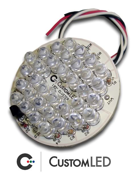

OK here is my 2c and what I did.
My undertail uses the standard 2" lenses and Like everyone else, Mine were way too dim during the daylight.
I searched high and low and came up with a workable solution.
It was a time consuming process since I had to carefully dismantle and fabricate to get these boards to fit.
Deal is they are extremely bright and the signals flash alternating Red/Yellow.
Here is a pic of the board and a link. You can get different colors to match your bike or preference. I went with just the basic yellow/red.
Be sure to get the right assembly in the 1.85 universal.
As for being bright? You won't be disappointed.
Be sure too, that you use an enclosure that is water proof to house them. I used a piece of PVC pipe designed for whole-house "central" vacuum systems. It is thin-wall and just the right size. I cut the pvc to length and placed it on a piece of waxed paper and poured epoxy to fill the end. This created the shell. You just need to be creative.
Let me know if you have any questions and I may be able to help.
Custom LED Universal Round LED Clusters
