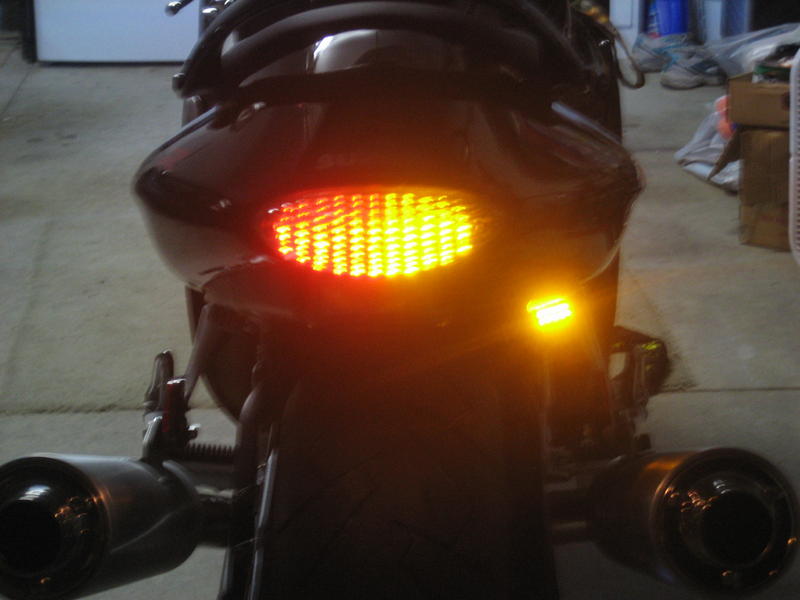

Removed rear tail fairing, reflectors and turn signals and set aside. Ordered two new 8 LED remote turn signals and placed them with electrical tape on a flat ceiling of the undertail and checked for symmetry and position. (Calif. needs to be at least 7 inches apart). (pic 2) Once found, remove electrical tape and peel blue tape backing and mount to position. Drill a hole behind the LED light big enough for the wires to be threaded through. Pass wires and add a dap of black silicone around the wire and hole to seal. Yellow wire goes to the positive side of the OEM connector and the brown goes to the negative side to the OEM connector. Repeat on other side.

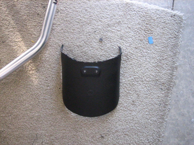

With a dremmel or simular tool, apply a cutting tool, use a full face safety shield and hold it in a vertical position, with the securing screw facing up toward the sky. I made a cut as close to the ceiling of the under tail as possible. (pic 3-4) I used a few files to straighten and smooth the edge thereafter. A torch lighter helped to finish the final edge.

Put it all together and Bam! Hope this helps.

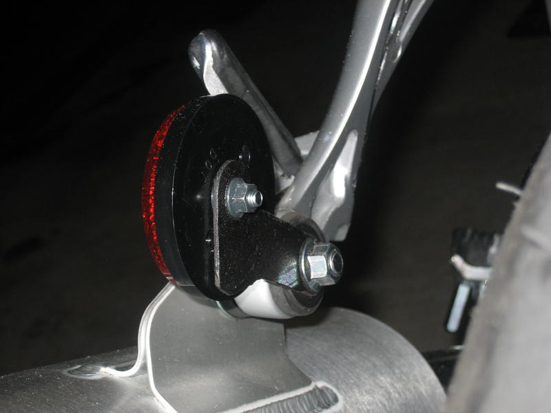

If your interested in the reflectors for Calif. bikes? This is what I did with those:

Heres a closer look at the LED light mounting.
