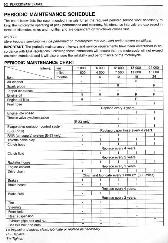

Get an owner's manual for the routine stuff. You got the link to the shop manual above for the more detailed stuff. Probably the best place to pick up would be at the 48 month service schedule. It's a repeat of the 24 month schedule in the shop manual , but you have the 4yr replacement items (clutch, brake and fuel lines). And it's not listed in the service schedule, but I'd have the fork oil replaced.

thanks guys, should i also change out the clutch fluid? if so how do i do that?
Check the TABLE that rusheriv above posted for intervals. The service manual details the procedure for that. Best to use a Mighty Vac, available from PASHNIT (site sponsor).
