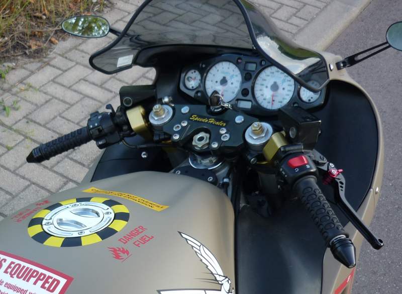

anyone have any info on or have used the tree in the first link? I like the look of the one from Pashnit a little more but the skeleton one in the first link is significantly less money, which I will be tight on after paying for the bike. But if the skeleton is a significatly lesser quality I am willing to spend the extra money.
skelton top tree chrome
Buy Now: Suzuki Hayabusa Parts & Accessories, Modify Suzuki Busa | Pashnit Moto
so on the gen I (which is what I am buying) you can lower it by more than 1'' by replacing the tree? and the gen II you cant? is that correct?
No, because your bottom clamps wouldn't go past the point where the forks flare outwards. (EDIT: I have a 2006 model, and my forks definitely flare out. I don't know what m_ridgeway is on about.) If you wanted to drop it more than that, you'd have to get new forks, or modify your current ones. You can cut the springs/replace them with shorter springs. I've seen it done...and it's a real pain in the ass to do. Plus, more than 1 inch in drop and you won't be able to ride it on the road because you'll have zero clearance.
If you get the block from Soupy's, you can still have your OEM top tree on top of it, which is what I did with mine, plus your bars will be set a bit higher, which makes it more comfortable to ride.
the one at pashnit is the rsd. you can only go 3/4" down with it. just the way its made.
the skeleton one i dont know about. looks ok, but i would like to know who made it, personally anything made by yana shiki i wouldnt buy. too many bad stories for me to try them out. stick with roaring toys, myrtle west, etc etc
