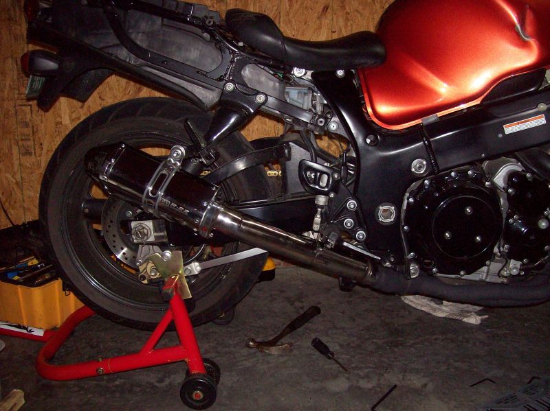

Here is my stock header modified to a single side
Here is a pic with the gutted midpipe and shorty yoshi can. I had to cut open the midpipe in 2 places just to get everything out then tig it back together.

I was thinking about modding the stock header to make a single exhaust.
Busashot
Jun 16, 2003
606
128
I did the same thing but modded the stock canister to keep it looking stock. I used 2 1/4" SS midpipe and 2 1/4" Perforated pipe for the canister
pack mule
formerly known as rtgt
Sep 25, 2007
2,167
13
Busashot, it was you that gave me that idea. I had seen it on here before but didn't plan on doing it until I trashed one side. Between the weight savings and being able to get to the chain easier it's a win-win.
