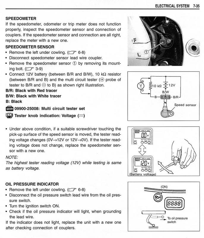

There is a test for the speed sensor in the service manual on page 7-35
According to the manual, if the sensor checks good, it recommends replacing the cluster. You might check the schematic and check continuity on the wires, since you mentioned voltage spikes a wire could have been burned, although I would think you would have smelled the insulation...

Page 7-35...
so since I don't have a computer, can someone copy/paste the testing procedure for the speed sensor? I need to verify if mine is bad or not before I buy a different one. Thanks again

can you see it like this?
are you on a BB?
if so click the link, itll take you to the pic, click menu button, view full image then you can scroll around and read it.
if not i can try to make it so you can read.
nope i'm on a "crackberry" a.k.a. Samsung Blacljack 2
