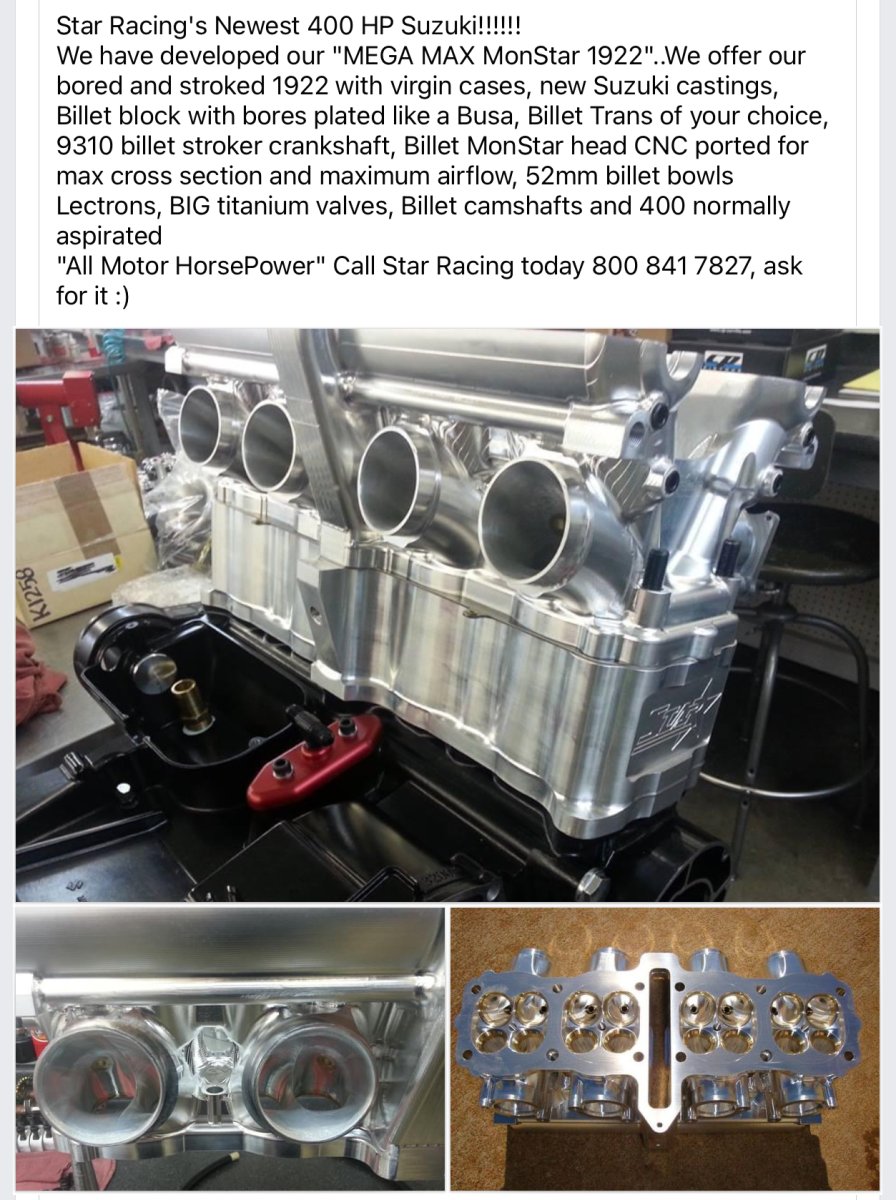

Old Skool builds like the 1900cc Star Racing n/a “MonStar” motors make up around 400hp so it’s not entirely impossible.
However…. You’re going to be throwing a lot of the motor in the bin, throwing a lot of money at very trick bits and development, and ending up with a very serious race motor with short life and very high maintainence schedule.
If you want to write some blank cheques I’d bet on 400 ponys being possible but not a route many folk would want to take.

I wonder how streetable that is?
Should I even ask what it costs?
And if there are Any parts of that engine that aren't aftermarket? lol
I think it was dropped from sale a while back. It was a very expensive, very serious drag bike engine. Just showing that 400 ponys from a normaly aspirated bike engine isn’t impossible. It was a brand new billet top end but used factory cases and some other stock parts in the bottom end.
I’d imagine it was a VERY long way from being streetable.
I found it very interesting, but I can’t imagine you’d get anywhere near those numbers and still have a useable streetbike.
