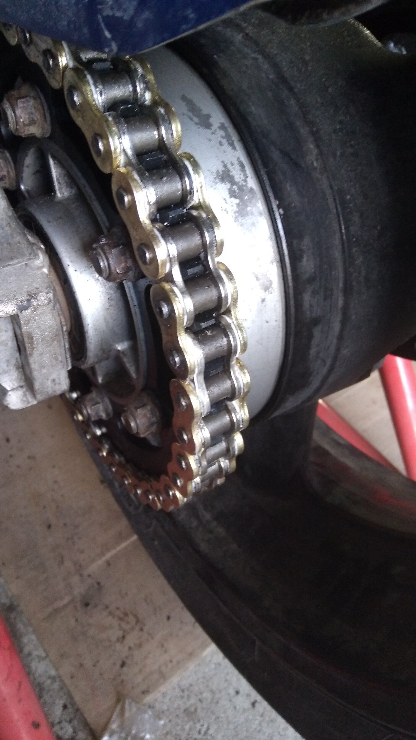

Metal clunking sounds like it's in this area.

I got confused as the picture must be looking up from the bottom of the engine which is an unusual view.
If the noise is coming from the sprocket area, it would be only happening when the bike is in gear and if so could be an output bearing, a seized link in the chain, or a worn or loose front sprocket...
I'd check the chain first then check the sprocket..

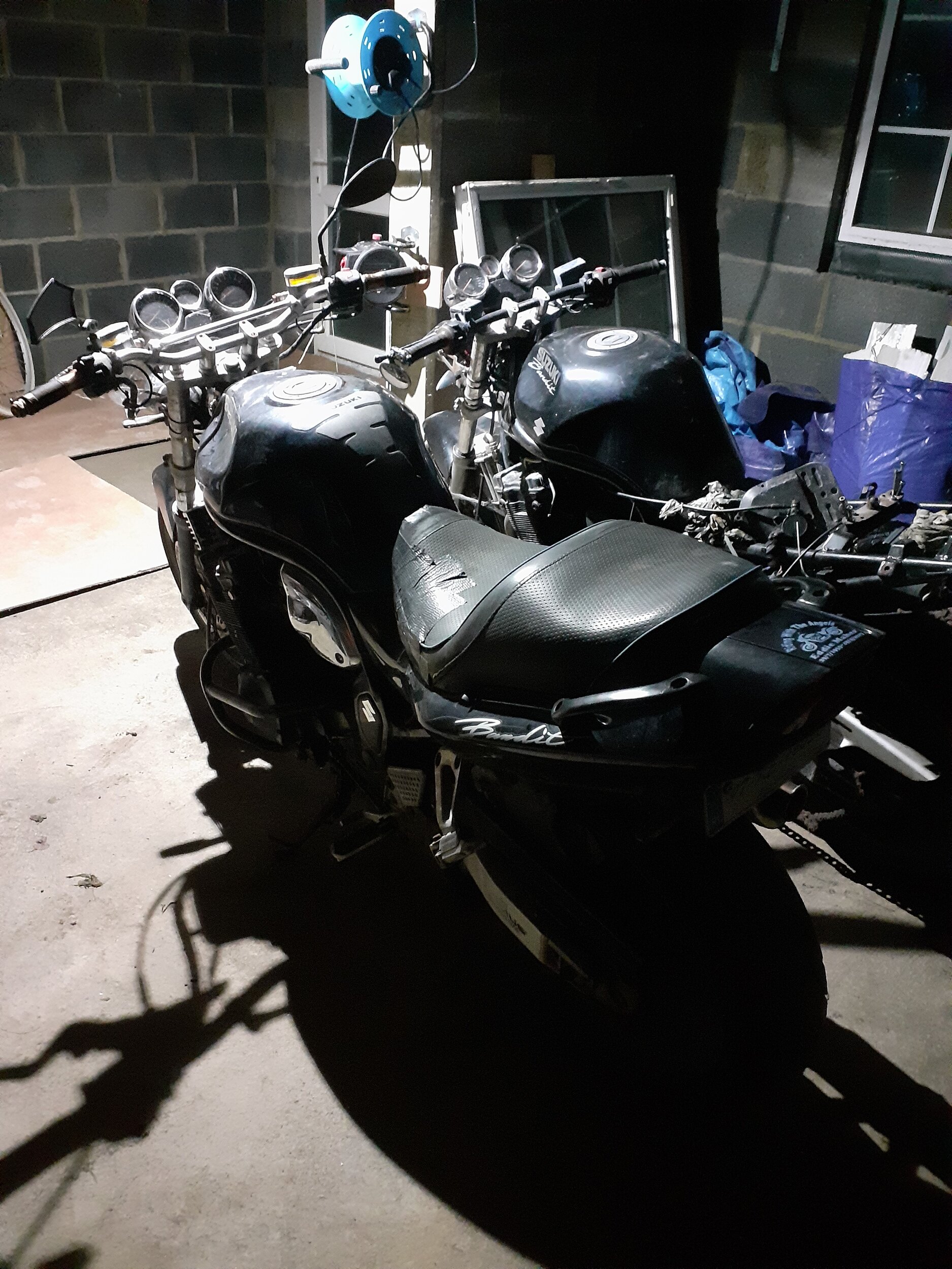

Brand new 17/40 530 kit fitted last week, I'll pull the clutch cover on Saturday, have to rebuild my bandit 12 engine tonight.

What's going on with the Bandit engine?
I had one of those and it sure was a stout powerplant.....another Suzuki that pulled like a tractor.....but was factory neutered for mid range. I changed that on mine.

That one needed a new oil seal on her return pipes, other one threw a valve I think when messing around with my mates busa so both getting tore-down.

Do you think it's the countershaft bearing clunking?
