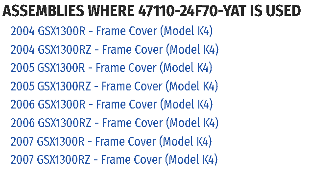

Using the K designation in numbers, a K8 would be an 06 wouldn’t it?
Suzuki skipped incrementing the "Kx" part designation for a couple years. After they changed the model in 2008 none of the prior parts were reused in the 2008 model. Since they were not reused they would not need this designation in the parts fiche. Thus the 2006 and 2007 parts that have no "K" designation, "K7" reflecting parts made in 2005 and "K8" reflecting parts made in 2008.
For those unfamiliar with this, here is an example of a part that shows how the "K4" designation visually points back in time to when it was first produced in 2004 and how it was reused in multiple years:
This part of my post is WRONG WRONG. @Berlin Germany correctly pointed out that the 1999 was designated as Model X, 2000 as Model Y, and 2001 as K1. Sorry about that. I wish we had longer editing time on these posts. That is okay as there is always redemption.
