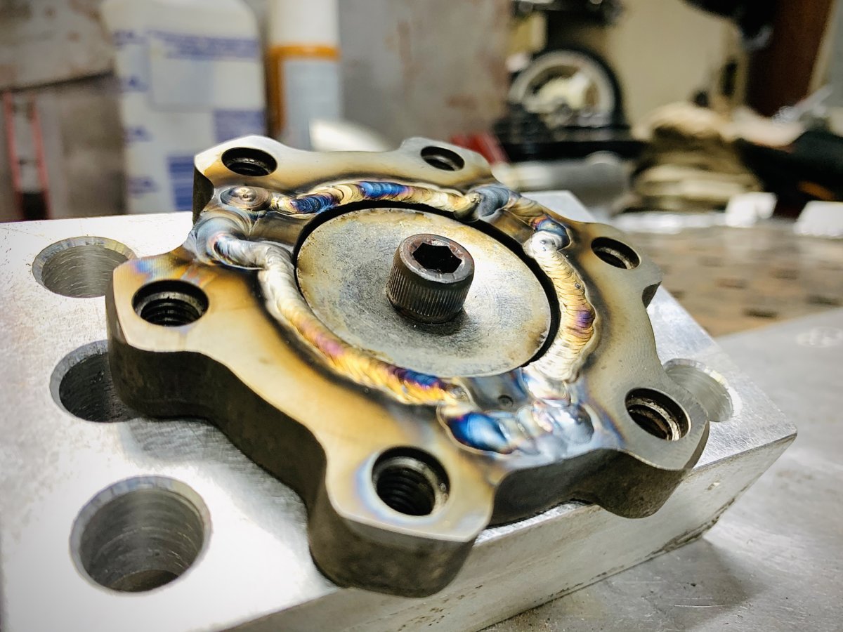

Gen1 clutch mod weld up.

Does the center part with the spline sit flush with the thing the pressure plate bolts to or does it sit raised up a slight bit like when it sits in the assy.? When you weld it.

Sits flush.
