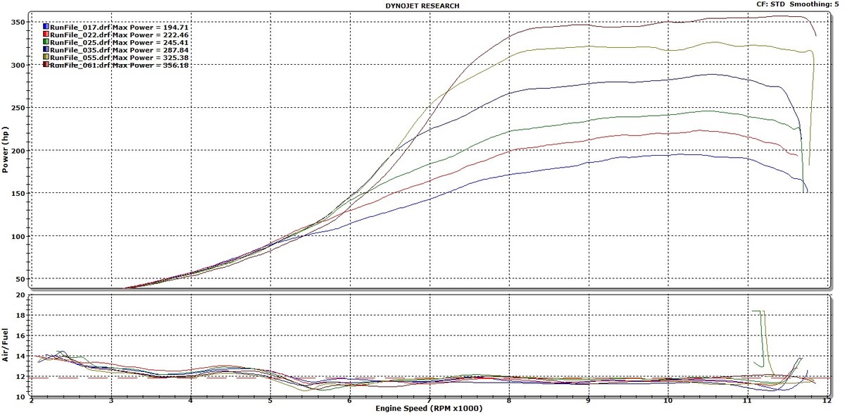

my bike picked up quite a bit using ecu flashing for tuning............but she has a turbo LOL
