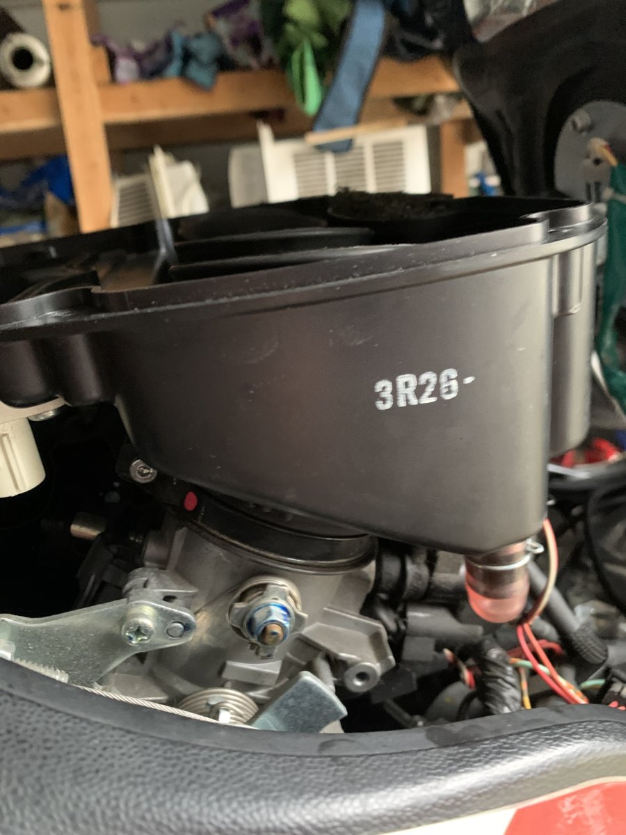

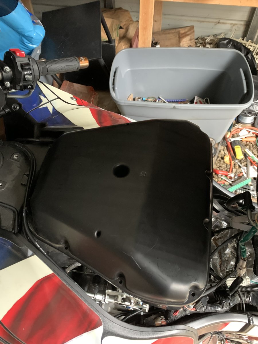

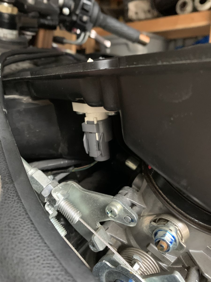

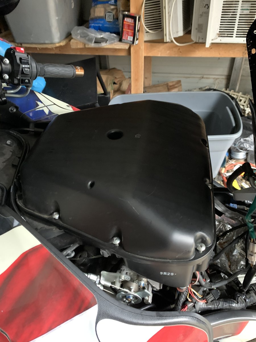

now you can reassemble the air box back onto the throttle bodies.. make sure they seat well so there is no misalignment.. then tighten back down the Allen head bolt clamp assembly...

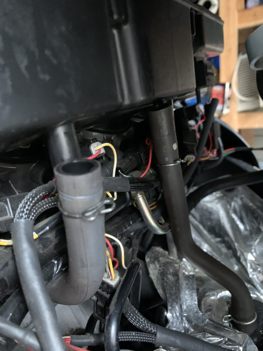

i apologize..i forgot to include how to take the bracket off.. 2 bolts 10 mm.. just use a open and closed end wrench to take the bolts off that are underneath the bracket.. little hard to manipulate but use the closed end and break loose then work with it till the bolts are loose enough to get fingers in there and unscrew them and pull the bracket.. i would do that before you put the plates on...
