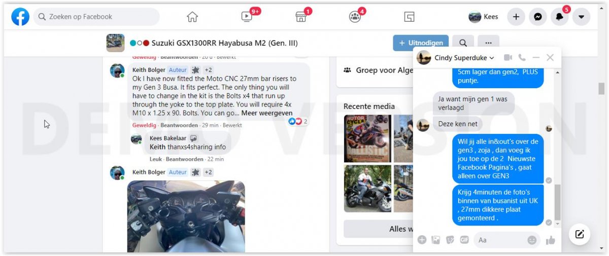

Keith Bolger UK , did install the 27mm kit from Mark Tindale ,first on this planet
