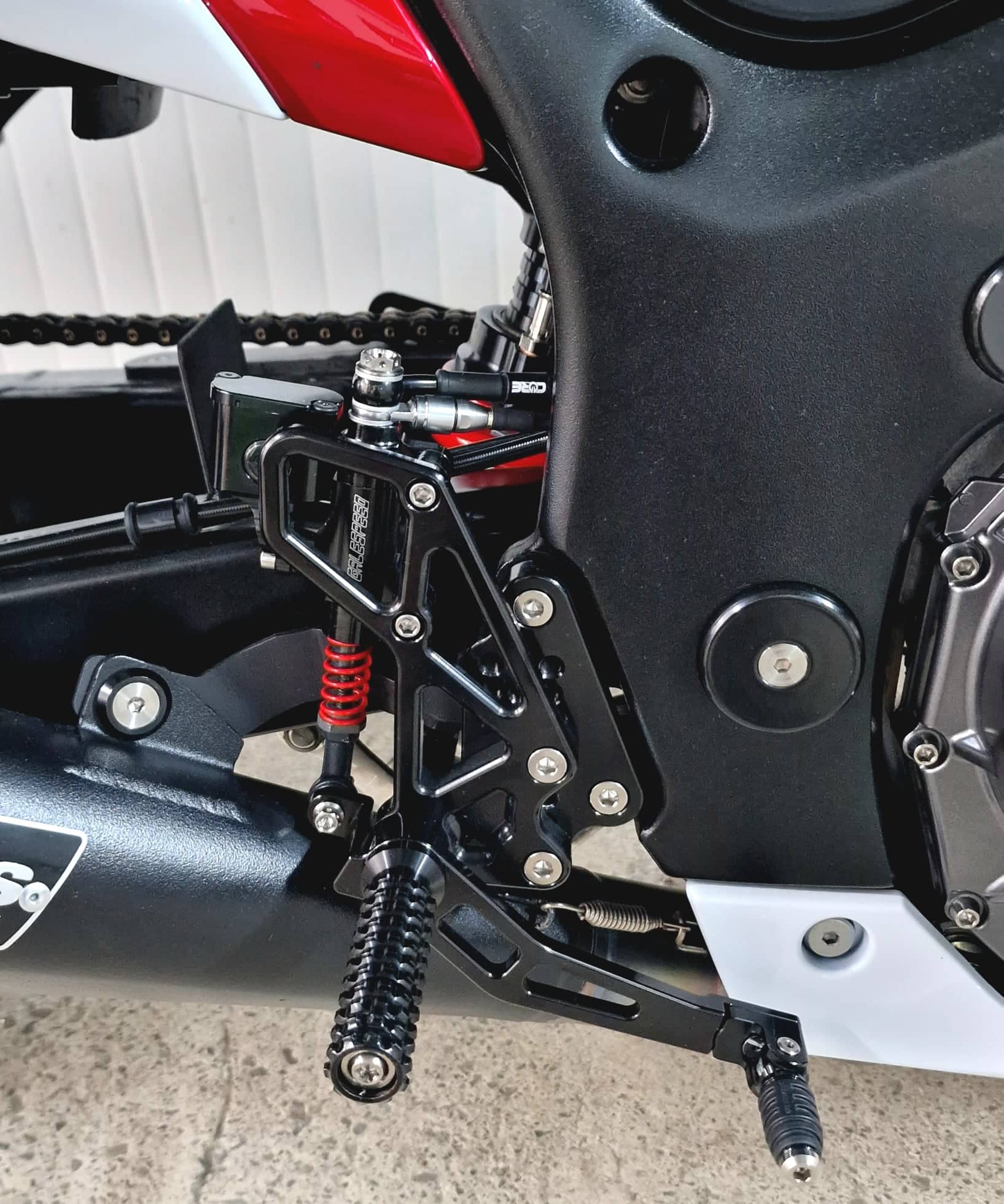

Found these on eBay ordered them in. Look to fit and decent quality but the shift linkage is way to long. Looks like it’s meant to replace the whole quick shift mechanism. Going to have to fab a short linkage to keep the quick shifter.

On initial look, the rears linkage is much thicker than the stock one. Im thinking I may have to take the Vortex one and stick it in a lathe and turn it down and then cut some threads myself on it.

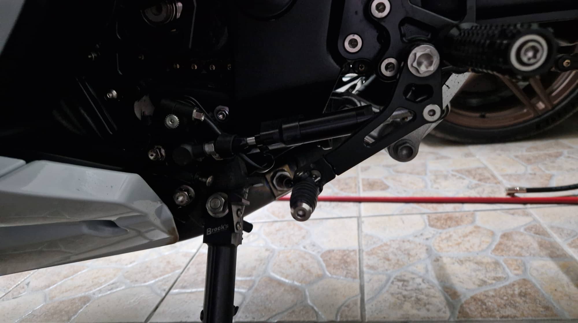

Gen 2 will work, you need to flip the quick shifter to do a GP pattern, For the shifter you will need smaller extension
I thought I posted this a while back
