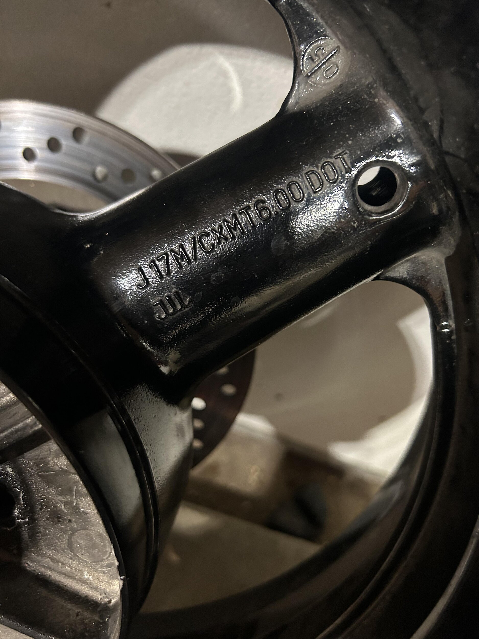

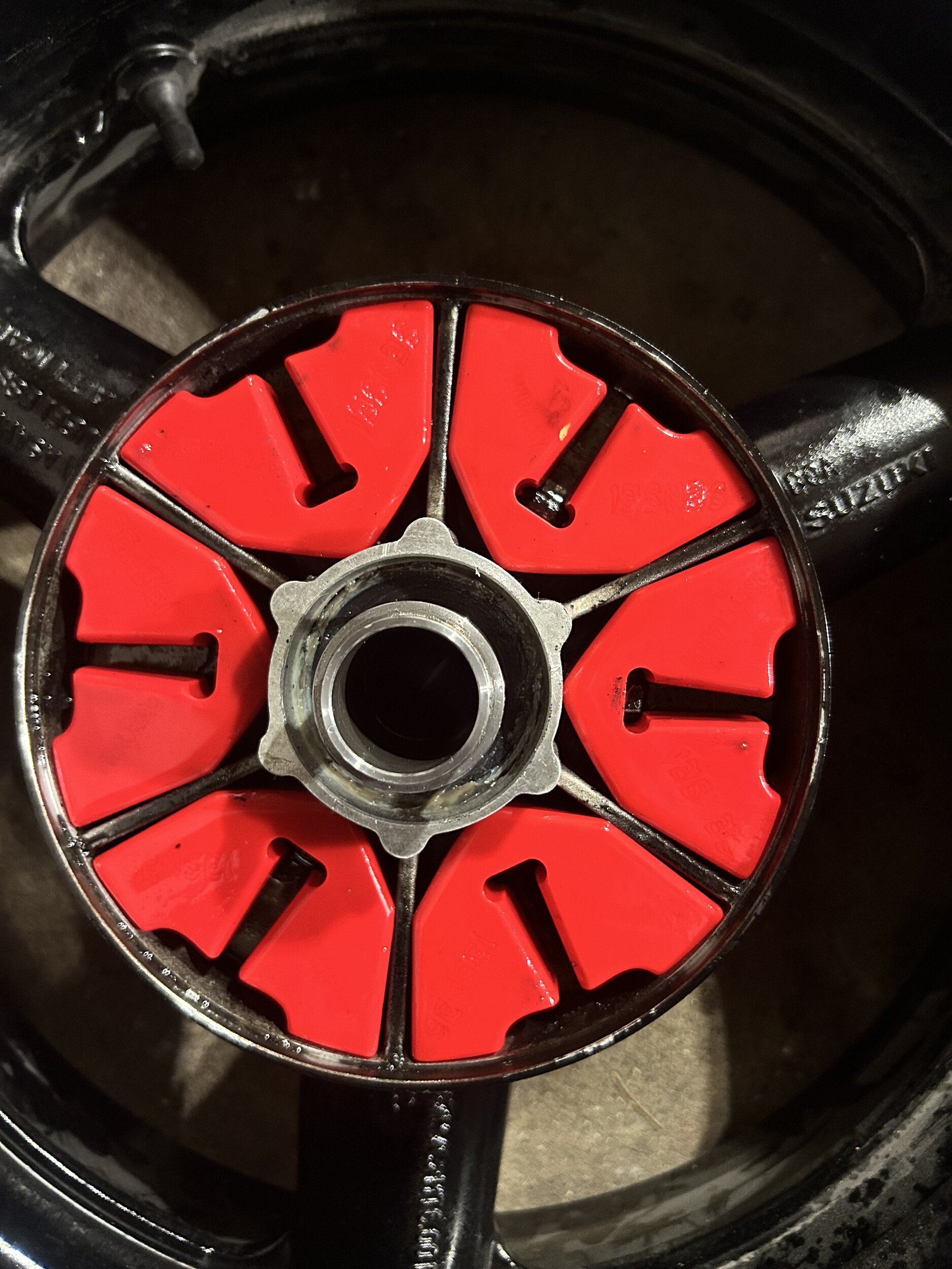

so i was changing the Cush drive dampeners on my gen 1, its a 2005 ; and i was having trouble as they did not fit . so i took a closer look at the wheel and it appears to be a gen 2 wheel .

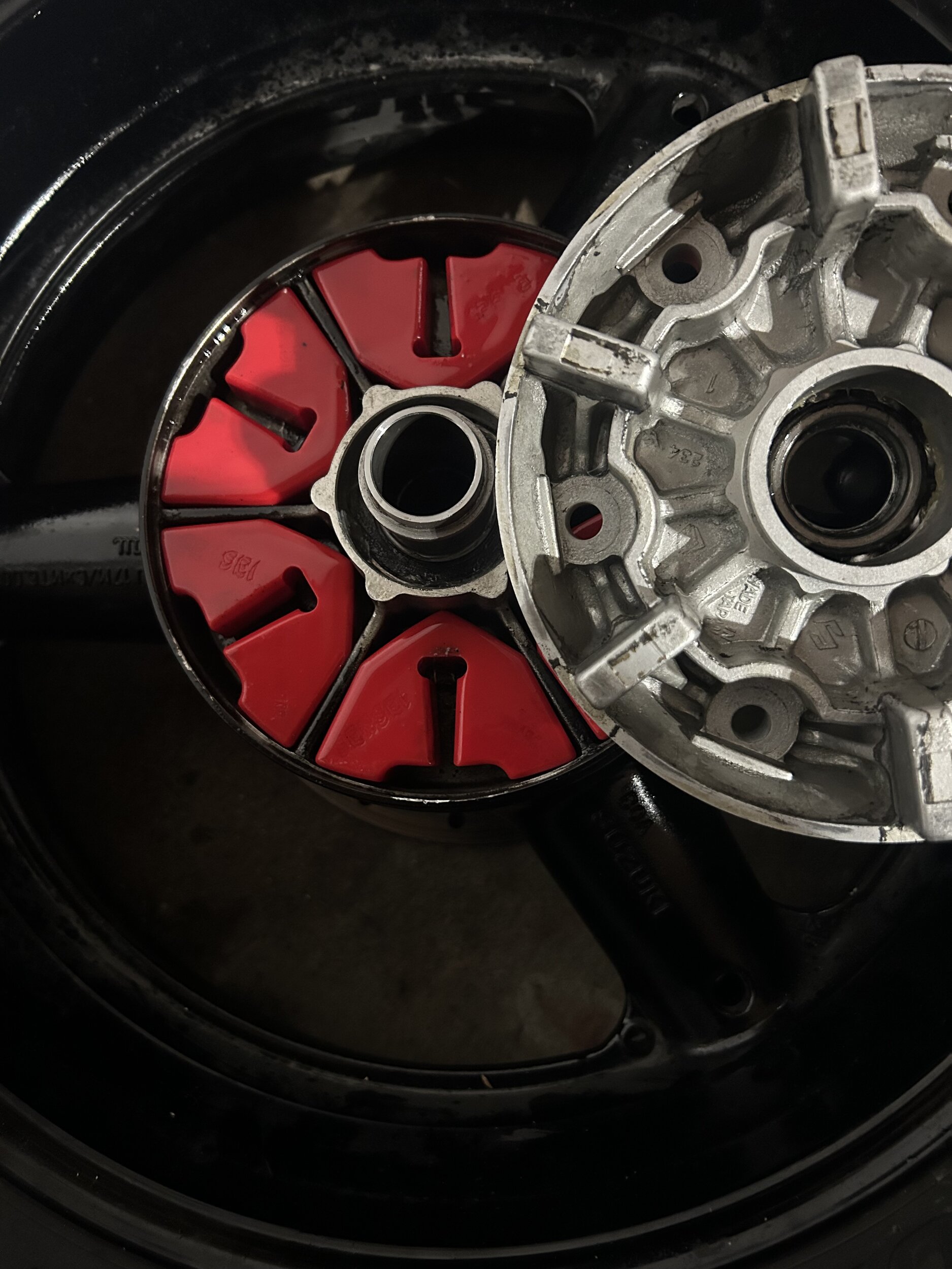

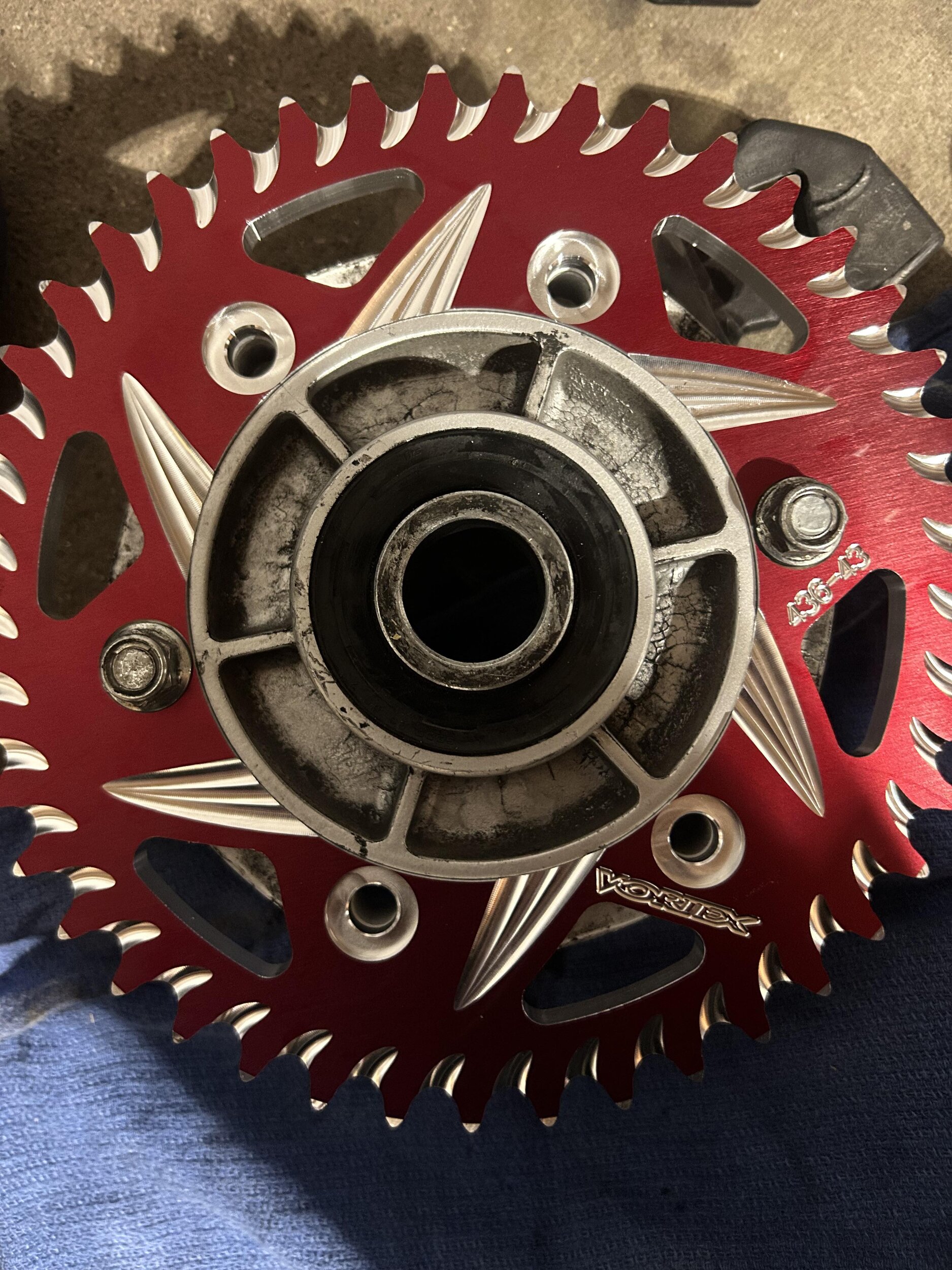

i put the sprockets on front and back without any bolts just to see , and everything lines up . the rear sprocket fits just fine as well as the front .

i figured it was a gen 2 wheel by searching the number found on the wheel

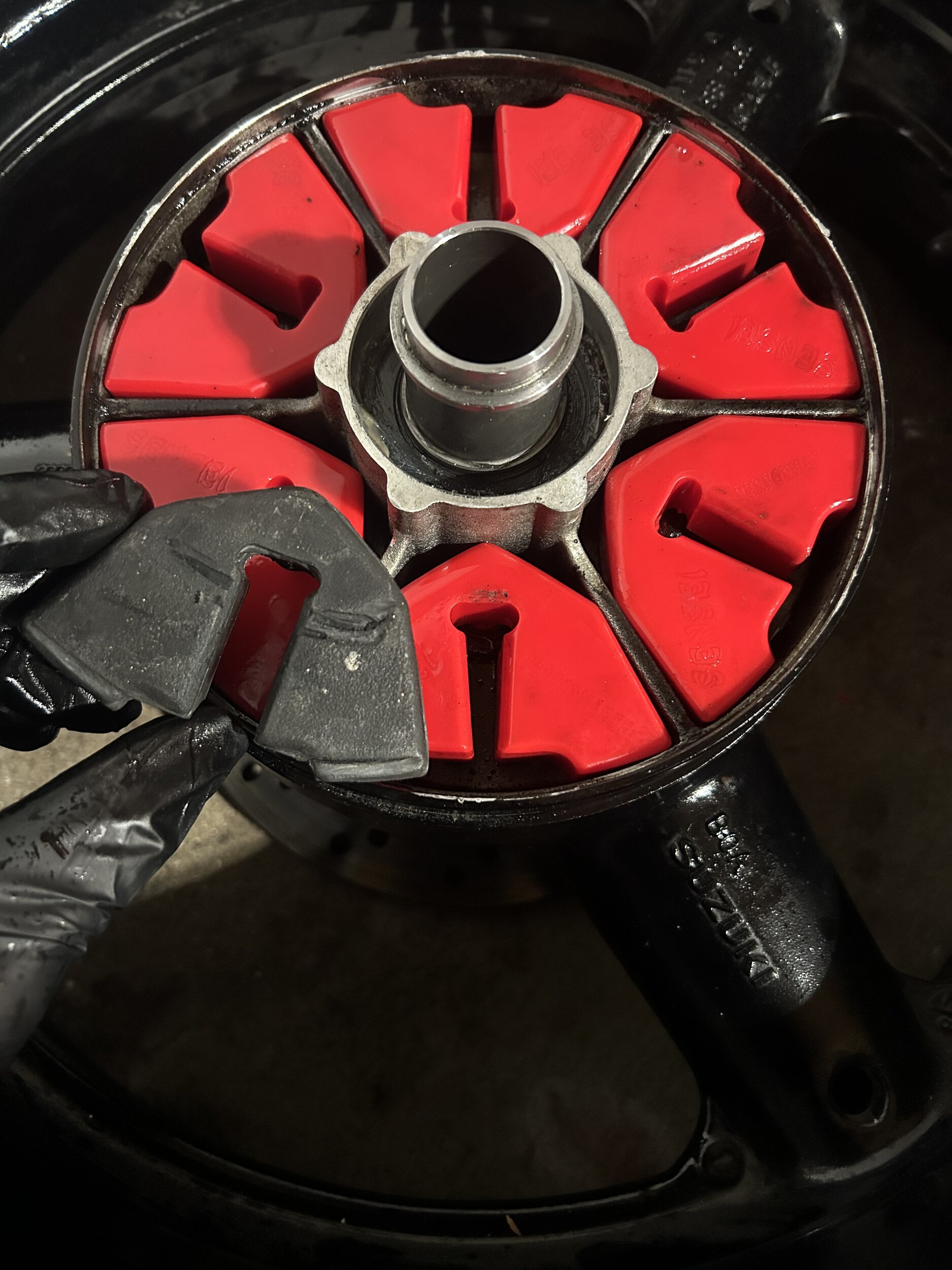

reckon I'm going to have to order another pair of gen 1 dampeners again ...

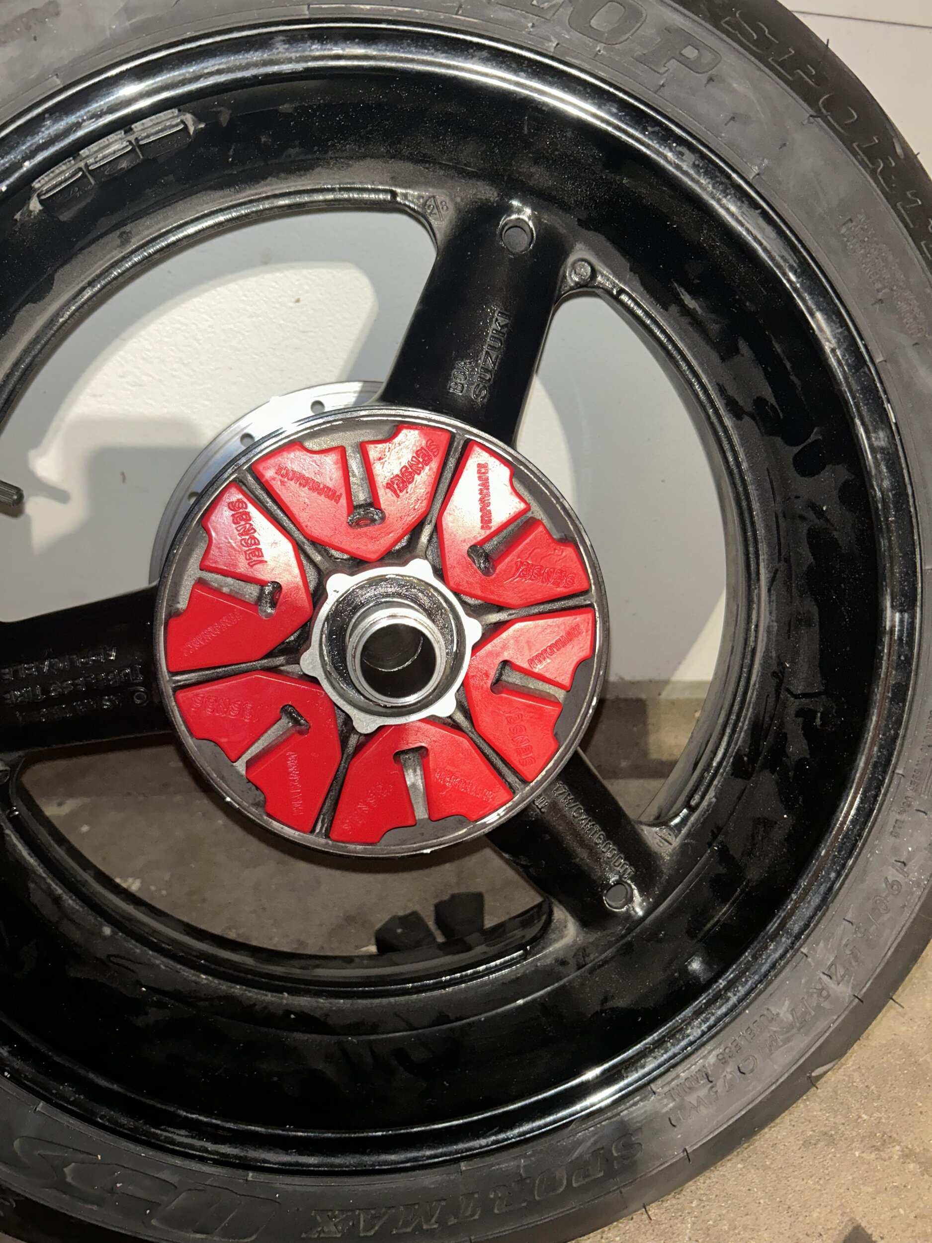

how do i get it in their though?? i stood on it and everything . it really looks like its a tad bit too big,, the gap on the bottom is closer together than higher up ?

Poly cush drives can make it hard to get the sprocket drive back into, and a light coat of silicone spray lube can help.
But those don't look like they work from the picture, no way the hub fits into those.

mannnn i know right that's what I'm thinking there's no way

Well I’m at war again
at least I have silicone spray this time . Still not going in tho ‍♂️
