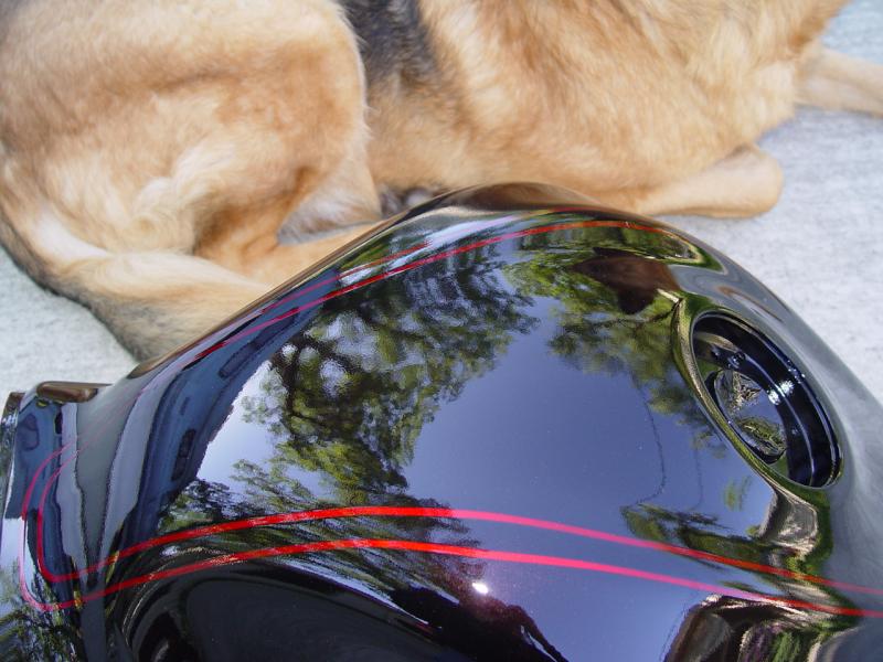

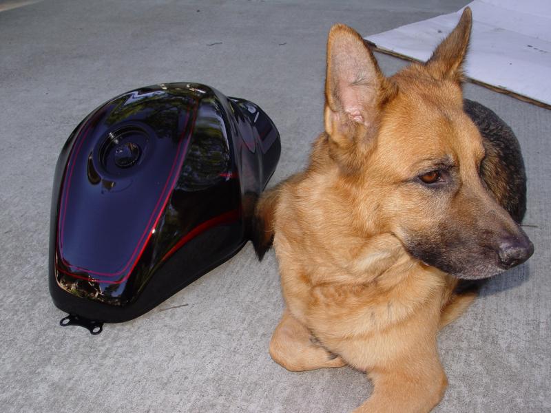

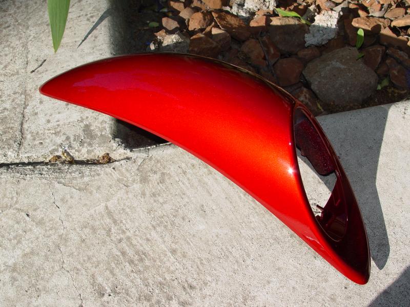

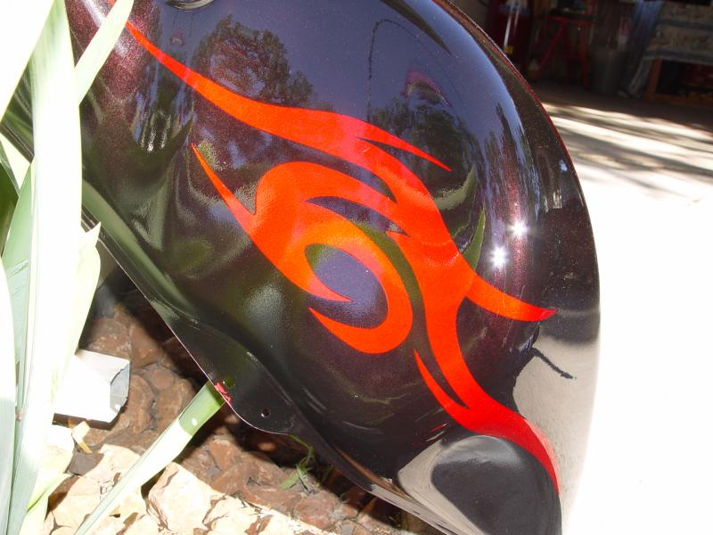

What a sense of relief to be done with the painting...To those of you who are painters or who have painted and are rookies like me you know exactly what I mean. Painting in itself is a very technical adventure...there are so many things that can go wrong when you don't have the experience to know. The two things I can tell you about painting that are critical to your mental sanity are these...Never ever ever use a rattle can (spray can) to paint or primer your bike....it probably cost me an additional 300-400 dollars worth of material to correct mistakes related to spraying with these demonic devices due to "spitters" (extra globs of paint). Temperature is also important...Paints are meant to be used at around 72-75 degrees...Using a rattle can outside in a light breeze at 55 degrees will **** with your sanity. You might think..just sand the extra glob of paint down. which I did on some pieces a half of dozen times...but you still have the extra pigment even if it is flat. Did you know that paint is not only a paint...it is also a solvent..so when I would spray a color coat over the spray can primer..that extra pigmentation which is impossible to sand out unless you do down to bear plastic would react differently with the spitter pigmentation than it would with the flat gray of the rattle can primer..which would cause "lift" and would be readily visible in the black paint...a fricking nightmare at best... The second item is always get with a professional at the automotive paint shop or pro level painter...believe it or not these guys will share their experience with you and don't mind helping a nubie. I had to strip my gas tank down to bare metal twice and paint it three times before I got it right due to technical issues with compatibility of different paints, cleaners, and glue backings on frisket paper (frisket is a vinyl plastic cut out of a design that has a very light glue that acted as a mask over the red paint)....so, get professional advice...they don't mind telling you what paints go with what primers..what go with what clears...on and on...
Just a couple of extra pics and then it is time to work on the bike...

looks great, :thumbsup:
CCbusa05
Jun 2, 2005
1,965
WOW! Make sure to take pics when she's all back together! NICE!!:thumbsup:
05 Busa LE
Oct 3, 2005
5,234
17
Have to give you lots of credit for investigating and doing it on your own, especially because the paint looks like glass. Can't wait to see it installed. Great job! PS Beautiful pup.
dalaster88
Jun 24, 2009
565
good job on the painting. and people think its as easy as just spraying, but there is a lot involved with painting. did you use a razor blade to lay out the graphics? I can see where you hand laid the stripes and tribal flames on the side and notice you must have dont small sections at a time with the way the curves are. But for your first time, that looks great
Blanca BusaLess
Suffers from PBSD
Oct 7, 2009
23,678
4,991
Wow , worth the wait.
I dont know whats prettier in the 1st pic though.
The dog or the tank ?
Great pup and keep up the good work.
Waiting to see it all together...:thumbsup:
My friend Chuck pulled a tribal flame off of the internet...cut it out on vinyl...then I took it to a graphics guy in Santa Rosa and he digitilized it...extended the points and smoothed the curves out...then I used that as a mask over the entire red surface and sprayed it black...that is the short version ...
