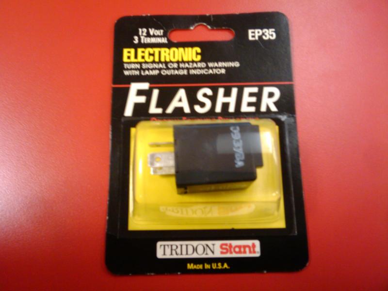

black07busa
Aug 31, 2009
291
I think they are discontinued, I went to a few auto shops around here, no one had it except Pep Boys $12.00. Last one in stock and it looked pretty old. I scanned the bar code with my phone and it showed amazon.com has them for $12.65. If you have a phone that scans you can try and scan the bar code pic below, and it should tell you who locally might have it.
