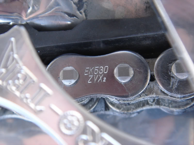

The ZVX2 chain is better to me than the ZZZ,several have found out..
How much is the ZXV2 chain I also have a 6" extension also. Is there anyone that can send me or know where I can get a Masterlink for a EK DR2 Chain ASAP!!!!!!!!!!
