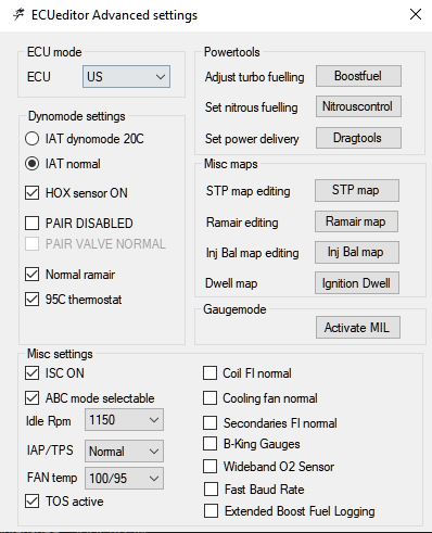

I have a couple of questions regarding ECU editor, the Power Commander 5, and the O2 sensor. First off I'm wondering why I cannot see AFR on either engine monitor, ECU Editor or PC5. All I see is a 0.0 under AFR? Is this normal?
Second question is about the "HOX Sensor On" checkbock in ECU editor. Should this be checked or not with the PC 5? I only have one O2 sensor and I'm assuming it's a wideband that came with the PC 5 (the PC5 was installed when I got the bike). Along that same line should the box for "Wideband O2 Sensor" be checked in ECU editor?

I'm guessing the ECU will never read AFR since there is none directly wired to it any longer. I did remove the checkbox in ECU editor for HOX sensor and checked the wideband O2 sensor box.
