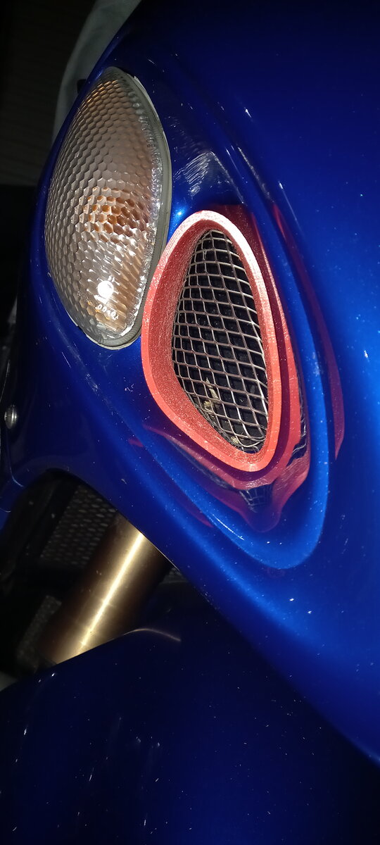

!!CALLOUT TO INTERESTED MEMBERS!!
So I've spent last night pondering what style would be nice but effective, I still havnt made a solid decision yet and I would like to know for you guys, what kind of styles do YOU have in mind, eceryone has a different taste, and I'd like to hear and see what your thinking of, if you can sketch it pop it up for me. Just remember, with 3d printing the possibility are endless, for the current time im printing a set of just straight out carpenter styles to check my measurements and compare them with the outlines of the body as to gain some sort of reference in my cad program. Current print time for a basic set at low quality is 16 hours per set

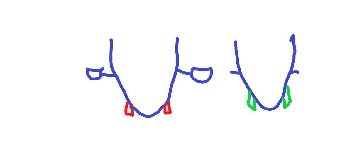

Maybe a nice contour on the top,meaning more rounded. Following the heavy lines the sig/screen holder already has.
Give it a rounded front and rounded top ^

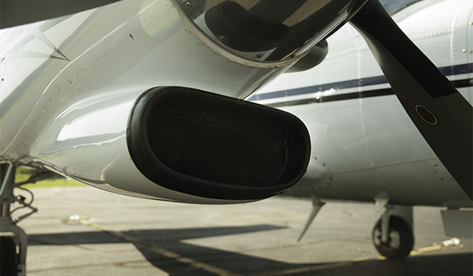

"Theirs" looks like some sort of vacuum cleaner nozzle,all square.
Perhaps have the left edge (red line) stick out further...
Have the right edge (green line) stick out less.
Excuse my crude drawing...top view showing mirrors for reference...NOT to scale...LOL.
It might be cool when looking down on them if the front of the tubes followed the contours of the nose...shown in green..and not stick out square and "boxy" like the red.
Just thoughts bro...IDK shi7...I'm the marketing department...NOT R&D. :laugh:

Less material used left side,following the line/contour of the turn sig (green)
More material to follow the contour of the intake/signal enclosure (black)
