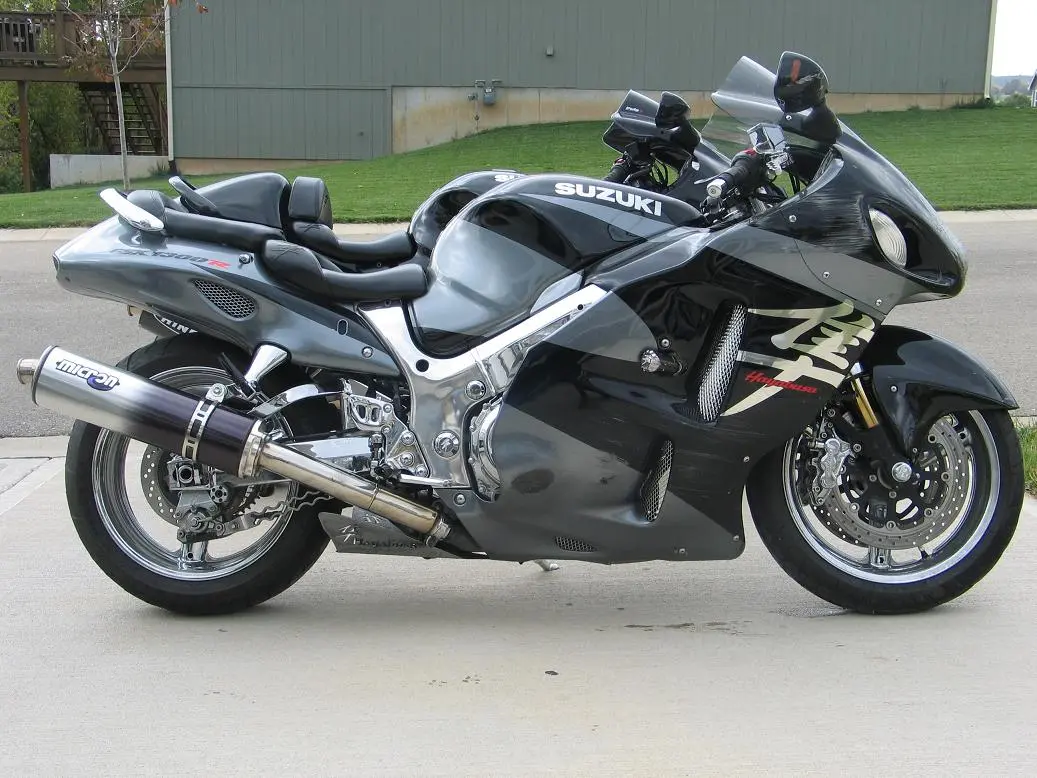

Probably should have shown this one first. Here's Baby J after a 30 MPH lowside and downhill, gravel slide. Still not bad.
