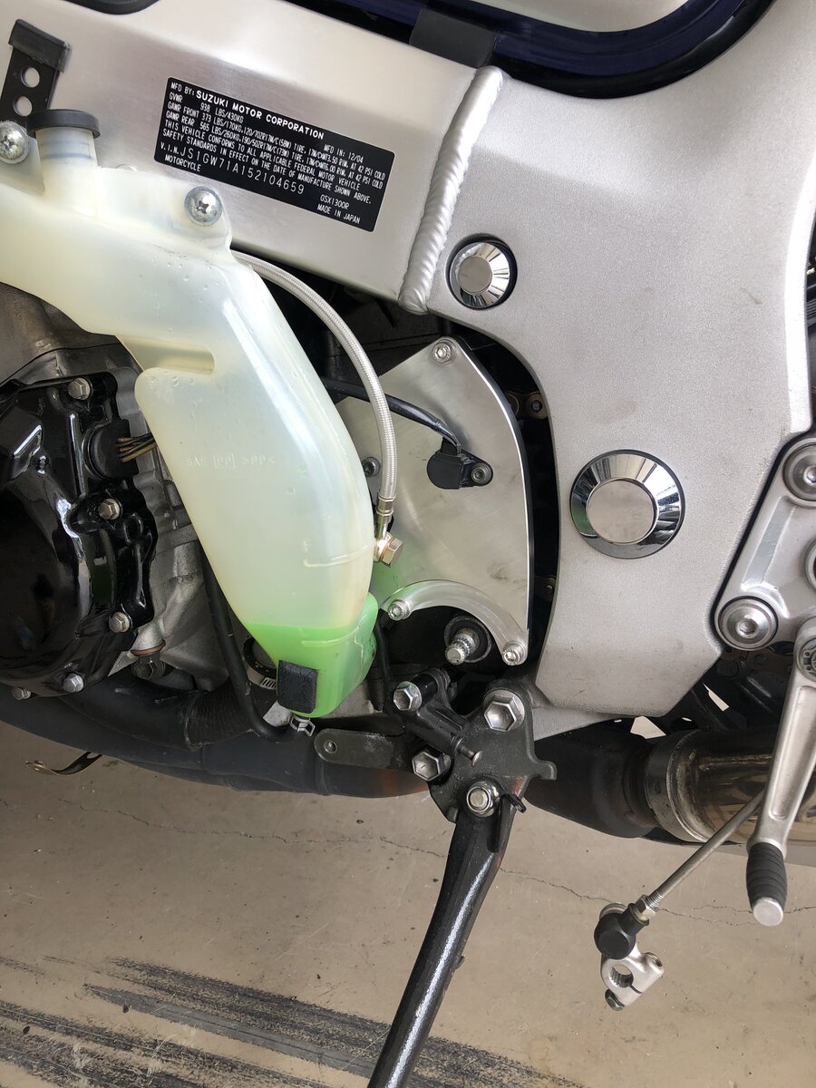

New sprocket cover same problem. Talk about a let down. The Schnitz sprocket cover looks good, and there's no play in the slave cylinder, new line on, but my clutch is still engaging with the slightest pull. Any ideas?
Ben Fischer
May 6, 2020
19
New sprocket cover same problem. Talk about a let down. The Schnitz sprocket cover looks good, and there's no play in the slave cylinder, new line on, but my clutch is still engaging with the slightest pull. Any ideas?View attachment 1619563
Alright never mind I think the slave is still moving! WTH gonna take it apart and re-check the slave. Wish me luck

Alright so I got the scoop.
We shall stand by...
Rubb.
Alight so the slave wasn't tight in its fitting. Now that's solved! I talked to the local mechanic and talked about my concern about shifting with minimal clutch pull and he reminded me you can technically shift without the clutch.... so I think that worry was a little unfounded. The upgrade has put me at ease though and the bike is shifting pretty well so I'm happy. Any ideas on further upgrades that won't break the bank?

So the slave is tight and not moving now?
Ben just because the Busa's clutch is hydraulic doesn't mean you cant change where it engages. If your still not happy you can mod the lever,try aftermarket levers or change the stack height etc. I've been shifting without the clutch on most of my vehicles for years.It was an' especially handy trick having had knee and foot surgeries on the left leg.(driving the cage was a drag). Once you get anything rolling the clutch is just an' option.LOL.
