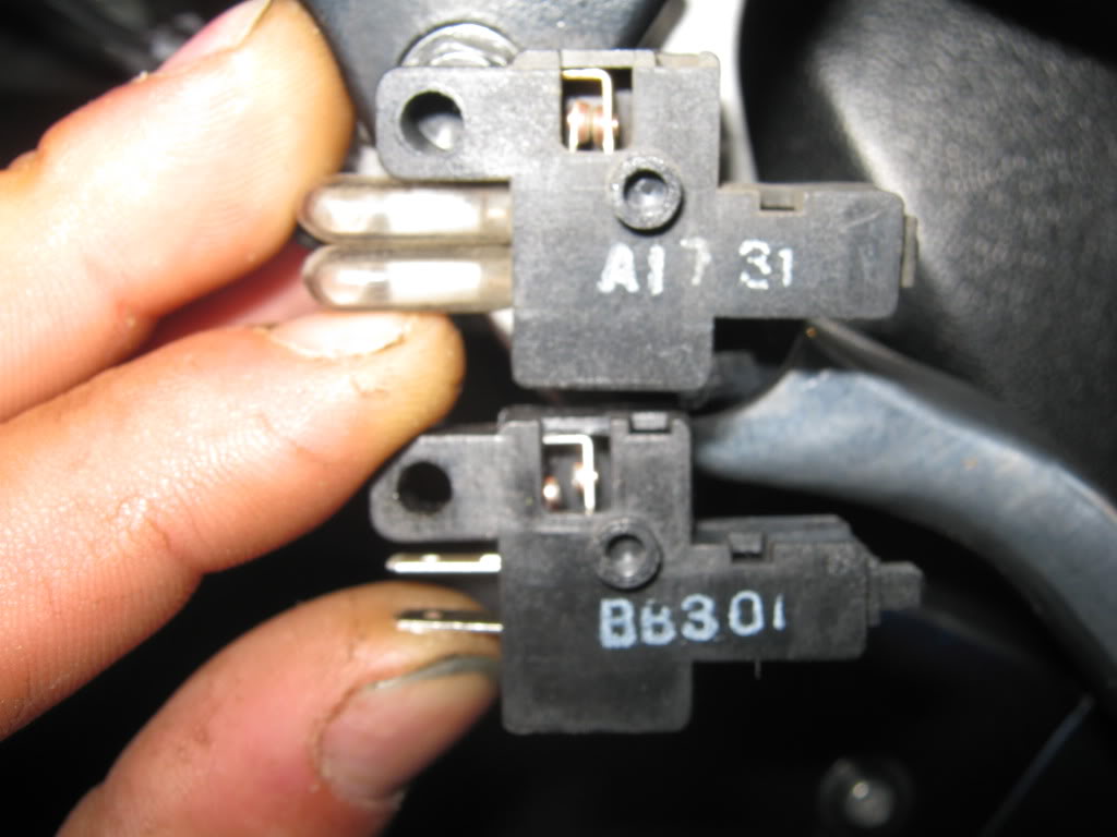

great news, once i picked up new clutch switch and looked at it i knew that was the prob. installed new switch and went for a hard ride trying to get light to come on but all stayed good :D here is a pic comparing old/new switch, you can see contacts stuck together. never seen one before so i didnt know they were suppose to be apart

Cheap yes pia to find lol. The manual says nothing about a faulty clutch switch can cause this. Guess I need to get a Suzuki crystal ball lol

Mine did the same. I just played with the connectors a little and they loosened back up. Saved me from having to by a new switch
