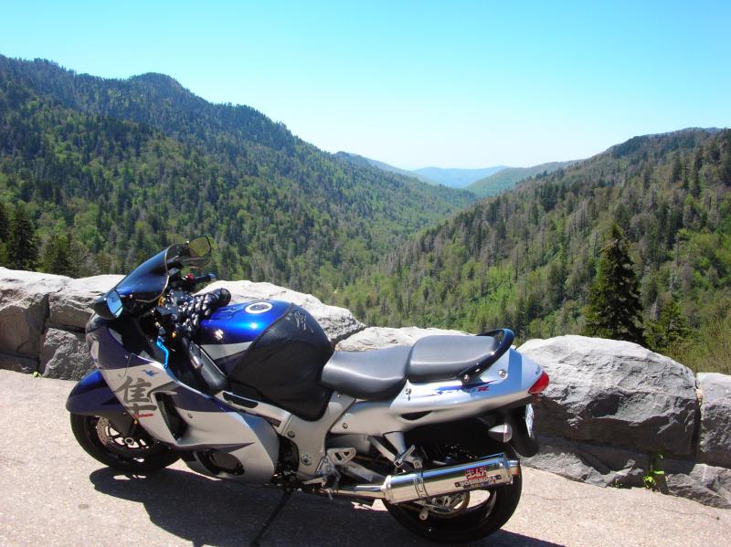

Stock pic btw

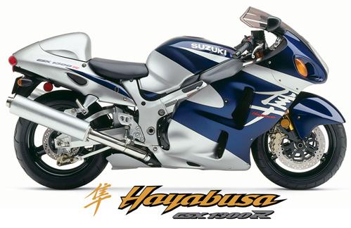

Stock 4 into 2, to my knowledge only D&D uses a dual aftermarket setup, no real practical reason for this except of you like the look or sound of dual exhaust.
Stock 08' example, 06' would only look slightly different
