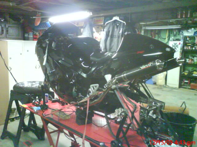

I am breaking the bike down to get some powdercoating done. I need to get both wheels off. Will i have to do anything to the breaks? Is there a way to make it stand up without the 2 wheels? I will be powdercoating back footpegs, front rearsets, rotars, fairing bolts, and wheels. If you have had black wheels and tried this, can you polish out the stock black wheels(whats under the black). If anyone has done some powdercoating can u please put some pics up. I have never broken down a bike.

Front and rear stands
I used jack stands. Put a rod through the front axle with jack stands on each side the then put 2 jack stands under the swing arm on each side. I used an engine puller to lift the bike.
