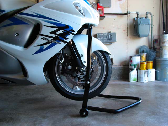

A front stand like this makes it easy. It's worth buying one.
